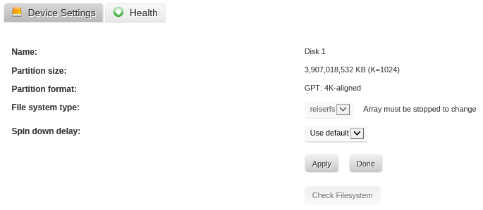

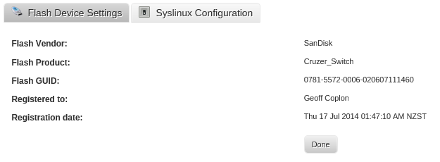

I can set those settings by going clicking on the drive in the Main tab (or Main/CacheDrive for the cache drive() and then from there selecting the SMB Security tab.
I am not running Active Directory, but I would not think that was relevant?
Active Directory actually IS relevant.  I've been frustrated enough by AD integration that I've reverted back to Workgroup.
Yeah sorry for the second post, figured it was better in Defect Reports with a bit more info.
Posted screenshots this time.

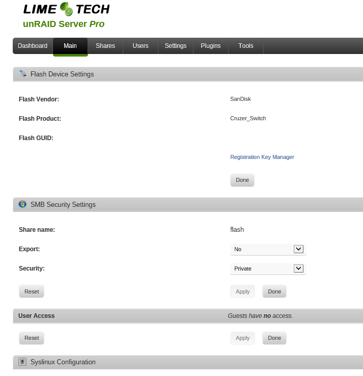

Just reporting that this issue is still there in rc5. Although it appears to have re-surfaced for the Flash drive (so partially fixed).
For clarity, the attached screenshot (flash settings) is what I'm expecting - the ability to control the disk shares via the GUI. Understood that this may not link into AD permissions but that should be acceptable to most!
