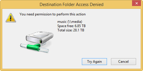

I've got the delugevpn docker running, and working great.  However, the files it downloads get set into a folder that doesn't give me proper permissions to move them to their final location.  I have to run the newperms script on the torrents folder to get all the files to permissions that allow me to move them from within windows.  I can't find any settings in the deluge GUI to change this, nor in the docker setup, so I'm at a loss on how to resolve this issue.
Here is the info for a recent download...
root@media:/mnt/user/video/Download/torrents/Game.of.Thrones.S05E07.720p.HDTV.x264-0SEC# ls -l
total 1377324
-rw-r--r-- 1 nobody users 1410374903 Jun 27 02:19 game.of.thrones.s05e07.720p.hdtv.x264-0sec.mkv
-rw-r--r-- 1 nobody users        281 Jun 27 02:19 game.of.thrones.s05e07.720p.hdtv.x264-0sec.nfo
running the newperms script is fast/easy...
root@media:/mnt/user/video/Download/torrents/Game.of.Thrones.S05E07.720p.HDTV.x264-0SEC# newperms /mnt/user/video/Download/torrents/
processing /mnt/user/video/Download/torrents/
... chmod -R u-x,go-rwx,go+u,ugo+X /mnt/user/video/Download/torrents/
... chown -R nobody:users /mnt/user/video/Download/torrents/
... sync
completed, elapsed time: 00:00:01
and gives me full permissions...
total 1377324
-rw-rw-rw- 1 nobody users 1410374903 Jun 27 02:19 game.of.thrones.s05e07.720p.hdtv.x264-0sec.mkv

So, after waiting too long for my terrible satellite internet to download everything, it doesn't seem to be working, but in a different way.
Now it's telling me I don't have access to the destination drive when I try to move a newly downloaded file.  I verified I do actually have access to the destination, so there must be something else going on now.
Now, it seems it's setting "nogroup" for the new files.  The following shows the new permissions on the top 2 files, which are the ones it just finished downloading after updating the docker.  The last 4 files are from the previous version...
