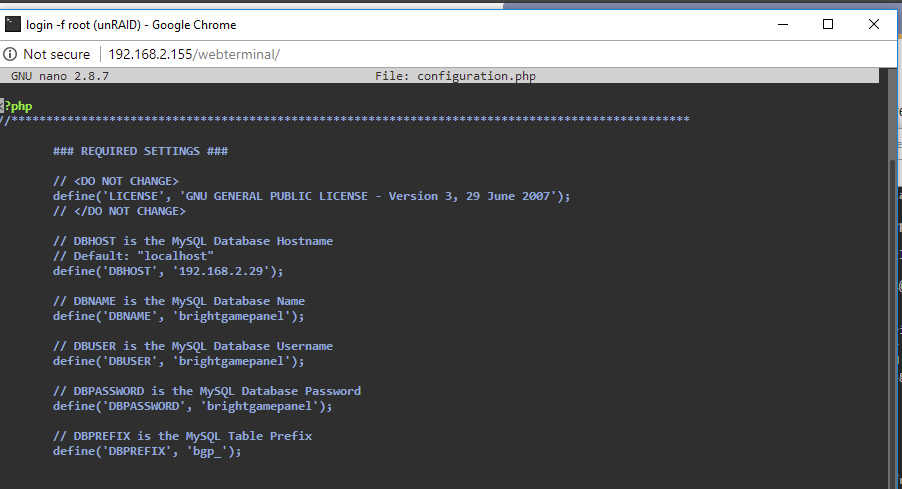

then stop the bgpanel container and go to the config folder you saved locally and edit configuration.php
the key lines are
// DBHOST is the MySQL Database Hostname
// Default: "localhost"
define('DBHOST', '192.168.1.10');
and
// DBPASSWORD is the MySQL Database Password
define('DBPASSWORD', '*******');
substituting the correct values for your setup, use ip address rather than hostname, it works better.

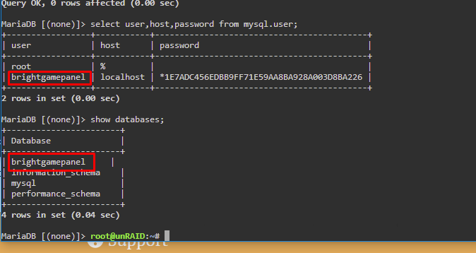

I used needo's mariadb container and edited the configuration.php file in BGPanel.
I started up the BGPanel docker and tried to get started
I attempted to troubleshoot to see if everything was good on the database side.
Anyone have any ideas on how to solve this problem.

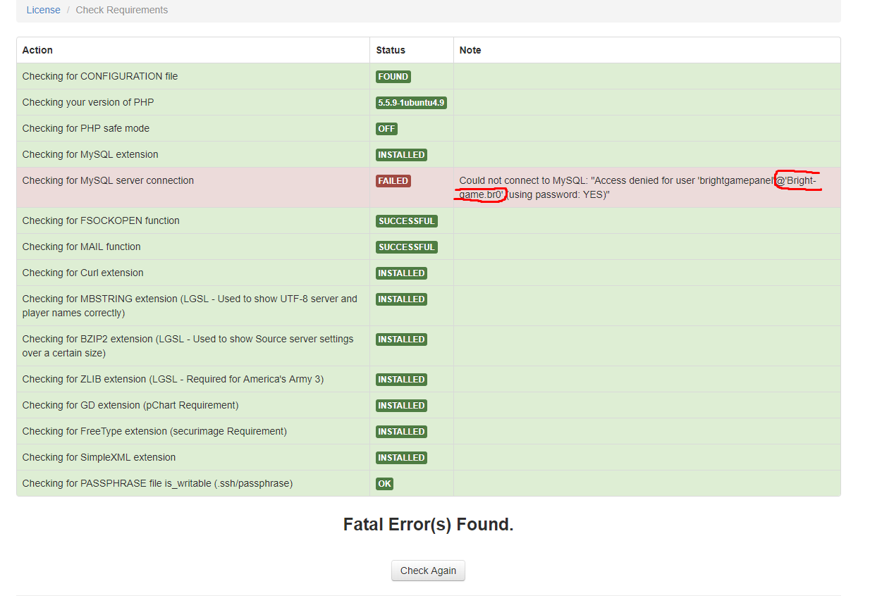

Hey sorry guys, I'm not sure if I'm being a giant noob here but I'm getting this error when starting up the game panel
configuration details
I'm not sure where it's getting "bright-game.br0' from
The database seems to exist from what I can tell
Anyhelp would be appreciated
