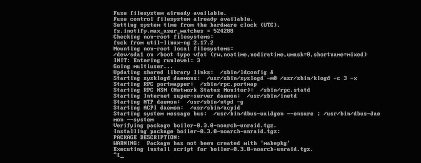

unraid wont boot after power issue
lost my UPS today.. now when I have all back up my Unraid wont boot correctly.
This would be the first time in years i did not do a clean shutdown..
stays stuck on Executing install script for Boiler-0.3.0-noarch.unraid.tgz..
On boot before the Unraid or MEMTEST.. any diags, checks I can do via CLI..?
Unraid 5
Running inside ESxi 5.5
suggestions?
Thanks again..
Hi
Pop your USB key into a Windows machine if you can and let it complete the repair process which should kick off automatically.
Let us know how it goes.
same issue.

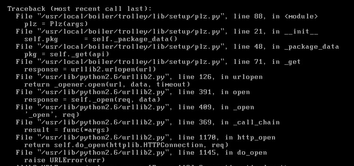

let it run few hours then got this in terminal..
Try removing all addons or boot in safe mode.
Specifically, those error messages you are getting are from a package called boiler. Its developer has been absent from these forums for 10 months.
I experimented with that package briefly, but it didn't seem to get a following. I don't remember now how it made itself re-install on boot, but must be in either /boot/extra, /boot/plugins, /boot/config/plugins. Don't think it did anything to the go file.
