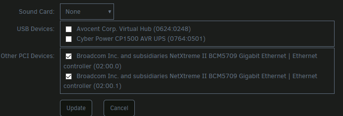

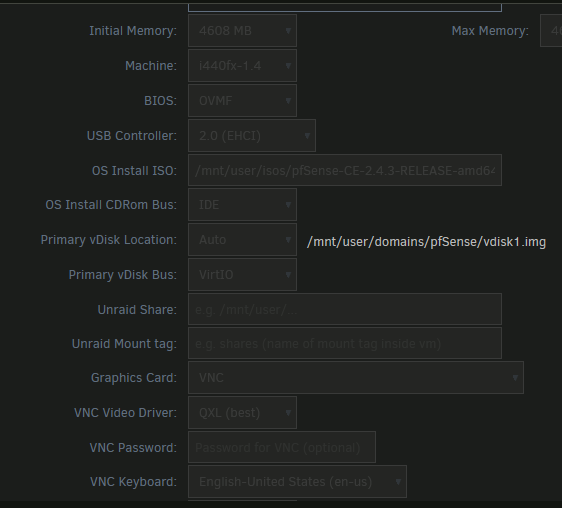

Worked perfectly for me with a X11SCH-LN4F motherboard, didn't even have to reboot and no need to edit syslinux.cfg. pfsense VM immediately recognized both ports (be careful to use i440fx, if you use Q35, the ports will only be detected if they have active connections which is not exactly what we want for pfSense). Haven't rebooted yet, unsure if Unraid will try to take the ports for itself, if so I'll do some syslinux.cfg magic but don't think that will be necessary at this point.
