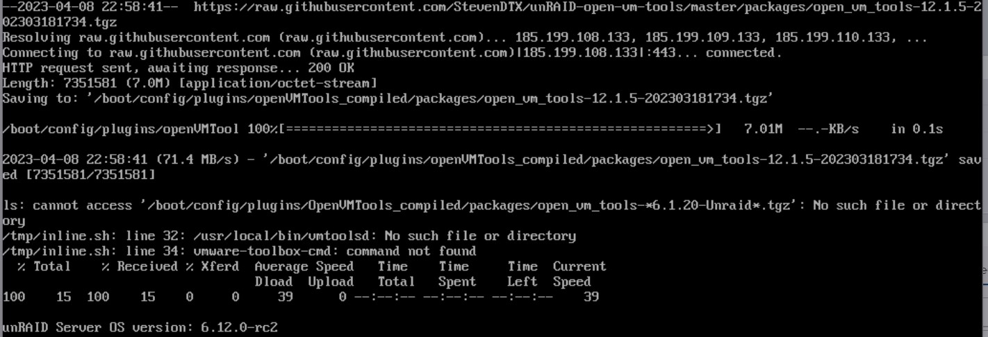

I'm on version 6.12.0-rc2 and getting the following error.
How are you installing it?  I just reinstalled it through CA and it installs just fine.
I upgraded to -rc3 today and it failed as yours did. I found a typo in a variable and updated the plugin.

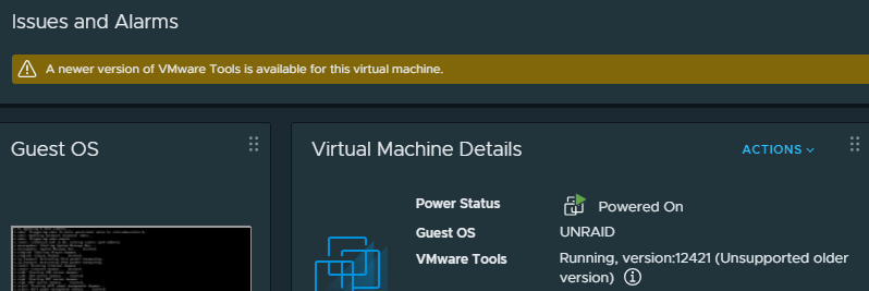

@Zeron / @StevenD can you update the plugin to the latest version please? open-vm-tools 12.5.0
In my ESXi i am getting a warning on the unraid vm that I cannot suppress.
Edited by mikeyosm
