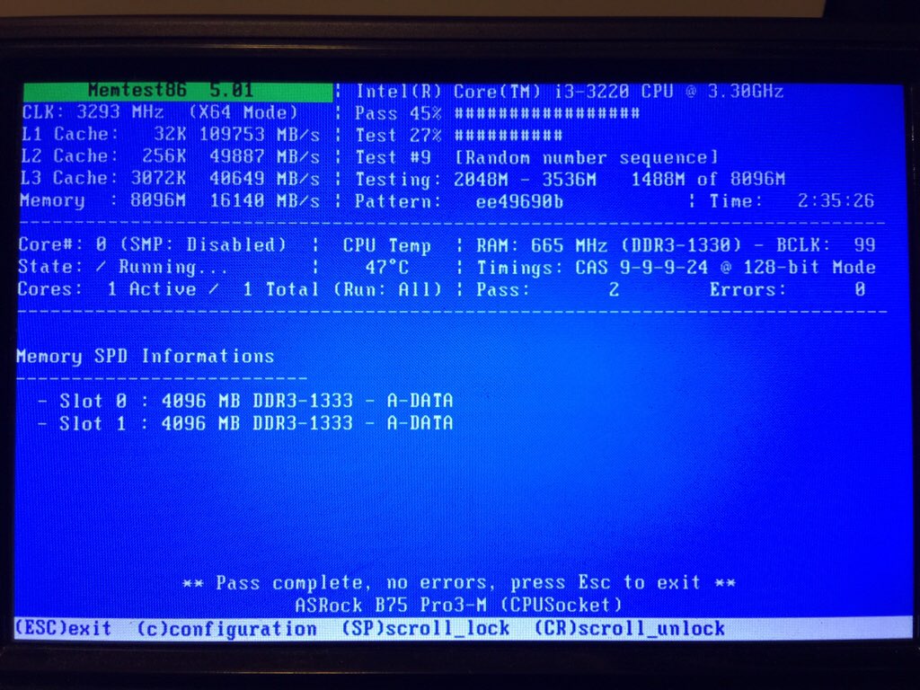

I would suggest that you run the MemTest option from the unRAID boot menu just in case!

Memtest running in progress, so far 2 pass.

That is promising.    Just thought it was a good idea when one starts getting a kernel crash to check that as memory that is starting to fail can cause all sorts of unpredictable symptoms.  Your issue is hopefully just the fact that  SimpleFeatures is installed.
