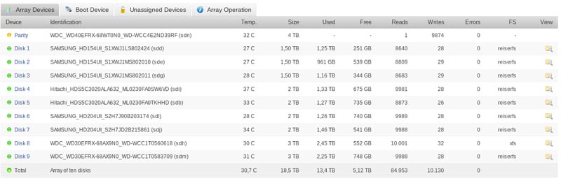

I read a lot about the topic but to double check, please verify the following procedure. I have an array of 11 drives. Two 1,5 GB drives are really old and smart warings occured lately. I copied all the data of these two drives two an empty 3 TB drive inside the array. So today I bought two new 4TB replacment drives. I'm running on UnRaid 6b14. This is my plan:

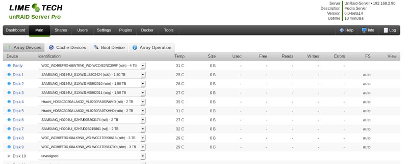

so I did it  :o I created a New Config. Before I made a backup of my flash drive. All entries of the colum FS shows "auto".  I have expected to see here reiserfs and in one case xfs. For me it looks like Unraid will try to format the drives  :-X Or is this correct at this time? Please help!!! Thanks!
Frank
Auto should recognise the existing format when you start the array.
If a drive shows up as unformatted do NOT format it - it may mean the auto code has not detected the format correctly.  If so you could try stopping the array; setting the format to what you expect; restart the array to see if it now mounted OK.
Hallo,
wowh that was really frightening, I pressed the button :-\ and it seems to work!!!! Thanks for your help!!!!!!
