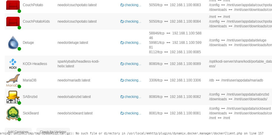

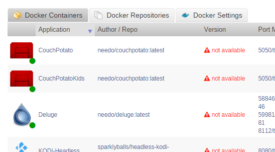

When checking for update's in Docker i get an error as well as adding a repo.  Currently only have myTemplates listed with no additional Repo's
screenshots and syslog tell the full story
syslog_4.zip

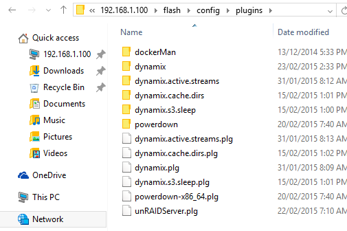

contents of plugins folder
Working for me. My folders are not as clean as yours (probably could get rid of some of it) but I don't see anything that should be related.
root@unSERVER:~# ls /boot/config/plugins
NerdPack/                    dynamix.plg*                 ntfs-3g-x86_64.plg*
NerdPack.plg*                dynamix.s3.sleep/            powerdown/
XTermTitle.plg*              dynamix.s3.sleep.plg*        powerdown-x86_64.plg*
apache/                      dynamix.system.autofan/      snap/
apcupsd/                     dynamix.system.autofan.plg*  snap-x86_64.plg*
dockerMan/                   dynamix.system.info/         unRAIDServer.plg*
dynamix/                     dynamix.system.info.plg*     virtMan/
dynamix.active.streams/      dynamix.system.stats/        webGui/
dynamix.active.streams.plg*  dynamix.system.stats.plg*    webvirtmgr/
dynamix.cache.dirs/          dynamix.system.temp/         wol/
dynamix.cache.dirs.plg*      dynamix.system.temp.plg*     wol.plg*
dynamix.kvm.manager/         images/
dynamix.kvm.manager.plg*     ntfs-3g/
root@unSERVER:~# ls /boot/config/plugins/dockerman
images/  template-repos*  templates/  templates-user/  webui-images/
root@unSERVER:~#

Alright, I clicked on the [check for updates] button and now it displays blue text of "update ready".
Here's the result of clicking on update, which indicates that it was already uptodate, after the following it now displays green text of "up-to-date".

All fixed, it seems having 2 out of 3 of my DNS servers set incorrectly was causing the problem.  This was working fine in beta12 mind you.  I know I had 2 of them set wrong but shouldn't it be picking up the 3rd which was working?
Tinkering with the DNS settings has had no positive effect for me. I still can't update templates, and the Docker images still show "Not available". I was able to update one time by changing my IP address via VPN, but that is no longer working.
I can't update anything. Changing DNS, activating VPN, nothing makes any difference, just no templates and all packages "Not available." I am still getting the error "#012Warning: unlink(/tmp/tmp-2066361256.tar.gz): No such file or directory in /usr/local/emhttp/plugins/dynamix.docker.manager/dockerClient.php on line 157". I have no way to keep my docker images current now.
Not Solved.
For me, once I corrected my DNS settings I had to go into each containers settings and click save one at a time. Then the error went away and they would update correctly
Thank you. That caused my containers to show updated. I still cannot save any template repos. When I try, it flashes that same error message above "#012Warning: unlink(/tmp/tmp-2066361256.tar.gz): No such file or directory in /usr/local/emhttp/plugins/dynamix.docker.manager/dockerClient.php on line 157". It is trying, and failing, to download something, and so the template list can't update itself. I'm trying to use gfjardim's repo.
This is a different bug. Run this command from terminal and tell us if it helps:
wget -qO /usr/local/emhttp/plugins/dynamix.docker.manager/dockerClient.php https://raw.githubusercontent.com/limetech/dynamix/master/plugins/dynamix.docker.manager/dockerClient.php
The command fixed the lack of templates. The error disappears. Then, when I "Check Updates", I'm right back to "Not Available" under versions, and the templates have disappeared. So, I go through the list, Edit each template and hit save, which forces an update. Then I'm back to "Up to Date" again. However, no matter how many times I run the command now, the templates will not update. The error message has remained gone. So to sum:
1) The command works once, and templates will update.
2) If you check updates, then the templates are erased.
3) Templates then revert to "Not Available".
4) You have to manually update them one at a time by entering Settings and clicking Save.
5) After this, the CLI command completes, but templates will not refresh.
6) The original error message remains gone.
There is nothing of note in the log, other than multiple lines indicating my server has become promiscuous, which I confess, makes me snicker every time. :D
Please try again with this command:
wget -qO /usr/local/emhttp/plugins/dynamix.docker.manager/dockerClient.php https://raw.githubusercontent.com/limetech/dynamix/docker-timeout-testing/plugins/dynamix.docker.manager/dockerClient.php
That works. It updates the template repo and restores the templates to the list. Then, when I check updates, over several tries, it is consistently updating half of them, the rest remain "Not Available".
Did you try to force an update on them? Click on the container's name and hit "Add" without changing anything.
That helped. Now I'm only getting one "Not Available" when I click "Check Updates."
