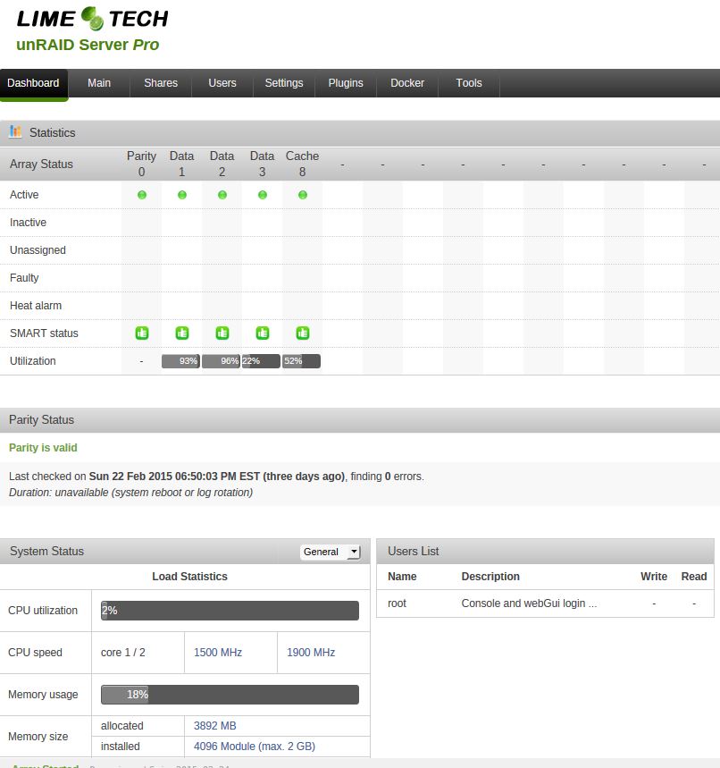

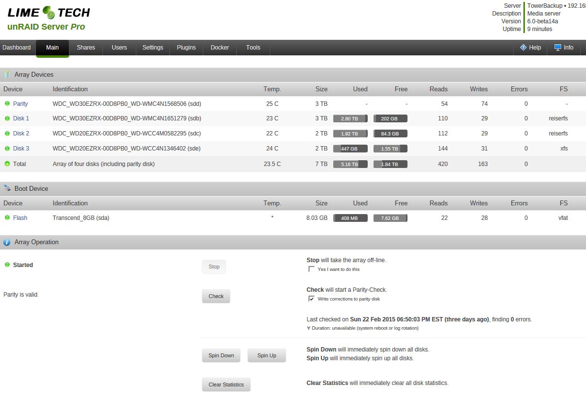

Just some quick results from the poll_attributes setting b14 vs b14a using unraid-tunables-tester seem to look like a ~3-5% speed increase on b14a
One thing I noticed is that I lost the cache drive from the tower/Main, the drive does show up on the dashboard.
Yes, I did clear the browser cache and also tried on both firefox and chrome.
Moreover the disks did not spin down after 15min, see below the messages from the syslog after the 15minutes have passed.
sdf is the cache drive

Observation on disk status indicators on Dashboard and Main;  After upgrading to b14a, I rebooted and the status indicators showed all of the disks in the array spun up (as I would expect). I came back after about three hours and brought up the GUI again.  I checked the status indicators and they showed all of the disks in the array spun down (again as I would expect).
I then opened a file and that I knew was on Disk 2 of my array (Array = parity  + 2 data) but the status indicator indicated that none of the disks were spun up (Not what I would expect)!
I then opened a file that I knew was on  Disk 1.  The status indicators did not show a disk spun up on either the Main or Dashboard pages.  (Once again not what I would expect!)
I then refreshed the Main page in the browser (I am using Firefox and did it via the reload symbol on the URL line) and the indicators changed from spundown to spunup for both Disk 1 and 2!
My setting on the 'Display setting' page, I have the 'Page update Frequency' set to 'Real time' and have checked the box for 'disable page updates while parity operation is running.'
In all of the earlier beta versions, I had no issue with the status indicators...
Same here.  I think that its a rather innovative solution to the spin down problem  :P
But in my case, no amount of refreshing (or clearing browser cache and refreshing) would show the disk as being spun up.  I tried adding poll_spindown="10" to disk.cfg, but the file is overwritten every reboot.
syslog.zip
Now it is showing disk 1 as spunup but the syslog is showing it as spun down.  After I examining the server, I reasonably convinced that the drive is spundown.  This appears to be confirmed in the portion of syslog below:
It seems to be a little random in when it decides to start working.  When I first booted my server, I immediately spun down all the drives, loaded a movie I knew was on such and such drive.  Main & dashboard said drive wasn't spinning.  Hit spin up, spin down, gui always said spun down.
Now, ~hour later I ran my md5 script (which pretty much guarantees all drives spin up), and out of the blue the dashboard and main shows all drives up.  Spin up / Spin down seem to work on the gui, but play the movie again and still doesn't spin up according to the gui.
I feel beta 14b coming up :)
