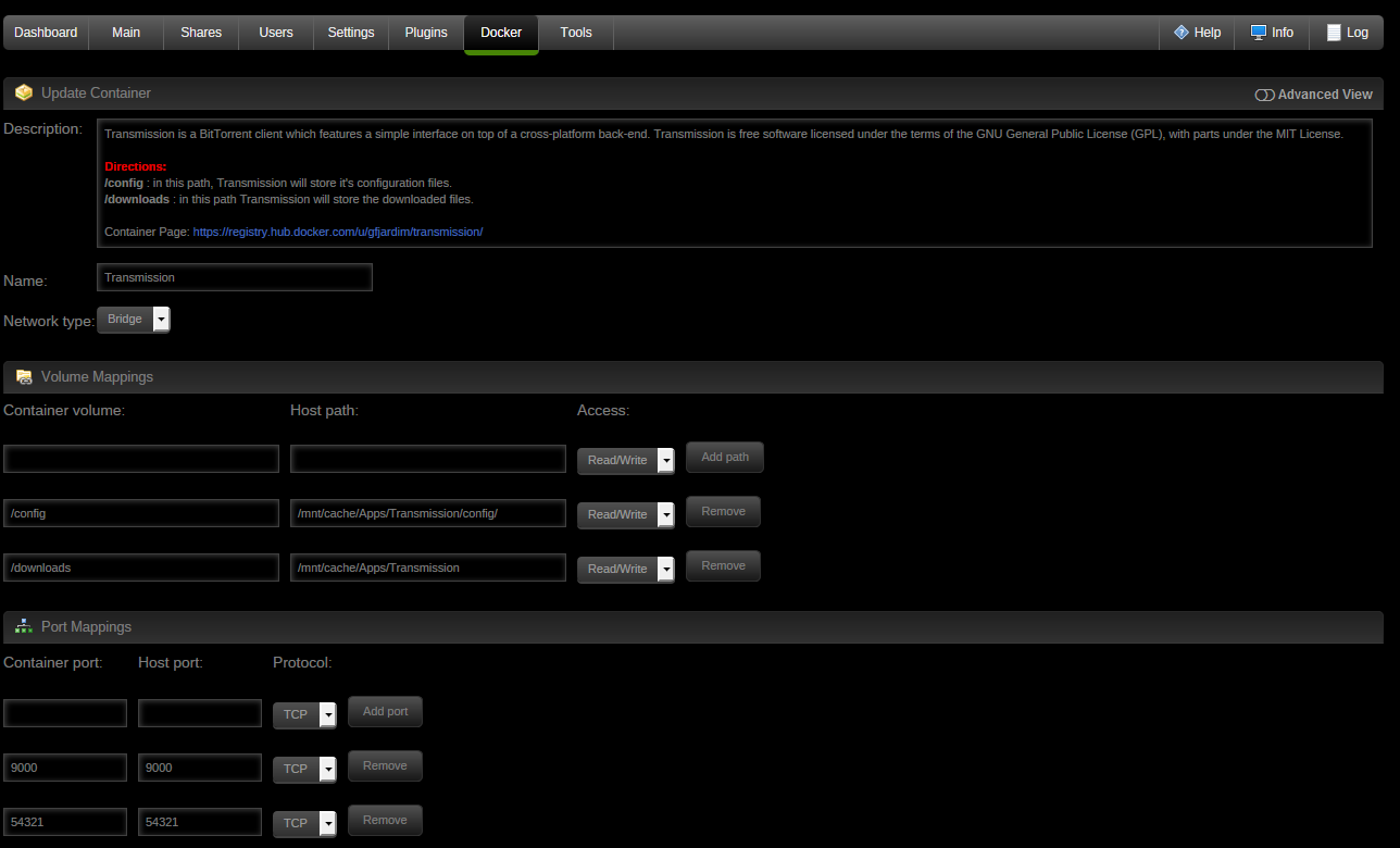

I just started playing with unraid 6 as someone on the forum suggested it would be better i used unRaid 6 then 5, as it is my new setup. I installed transmission docker however i am unable to download files using transmission, the download starts but comes up with a download location error. I tried to set it to /mnt/cache/apps/transmission/downloads but it does not work. what am i doing wrong here?

Can you post a screenshot of a copy of your config and details of which repository you're using.
I added a few repositories and then i just started setting up the Apps i would need the most, Transmission being the first, moving on to BTsync & owncloud. Transmission got installed however popped-up with the error so i posted here, attached is the screenshot requested.

Secondly, I don't use Transmission at all but to get the downloads working there will be two steps, firstly map out the config like the screenshot you have posted, then you will need to change the preferences within transmission.
I would suggest
1.  Create a download folder on your cache drive and set it to cache only.
2.  Map transmission /downloads to /mnt/cache/downloads in the docker config
3.  Then in transmission change the preferences so that your download directory is /downloads
That should work.

I set the download path in transmission setting (in the transmission GUI) to download to /mnt/cache/downloads so it starts to download however in a few seconds it stops and the error in the torrent details says:
Status:  Permission denied: /mnt/cache/downloads/abcd.mkv/abcd.mkv
OK, so lets check things now.
Your cache drive smb settings look like this:
Your download share looks like this:
Your download share smb settings look like this:
and then your transmission docker config should look like this:
Yes, they look exactly the same as the screenshots you posted.
