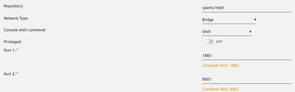

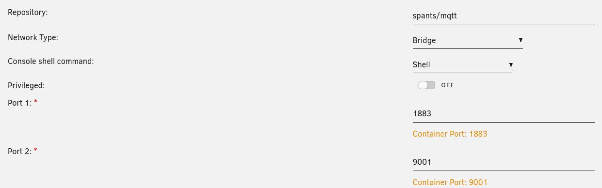

I have been able to use a lot of the docker containers, but MQTT has me perplexed.
I have read through almost all of this thread but can not find something similar.
MQTT is set as shown below. My server is at 192.168.1.90. I have created the password file. As suggested in other posts I made chmod the directory to 777, also chown to nobody:user.
There is nothing in my log file.
Home assistant allows me to add the MQTT integration but it does not discover my test devices.
Can someone point me in a direction.
Thanks.

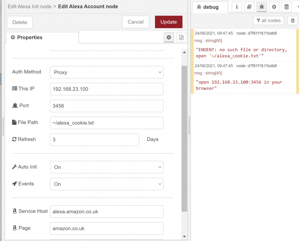

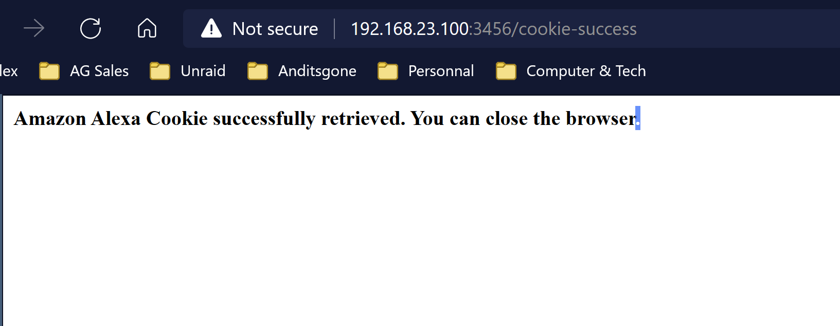

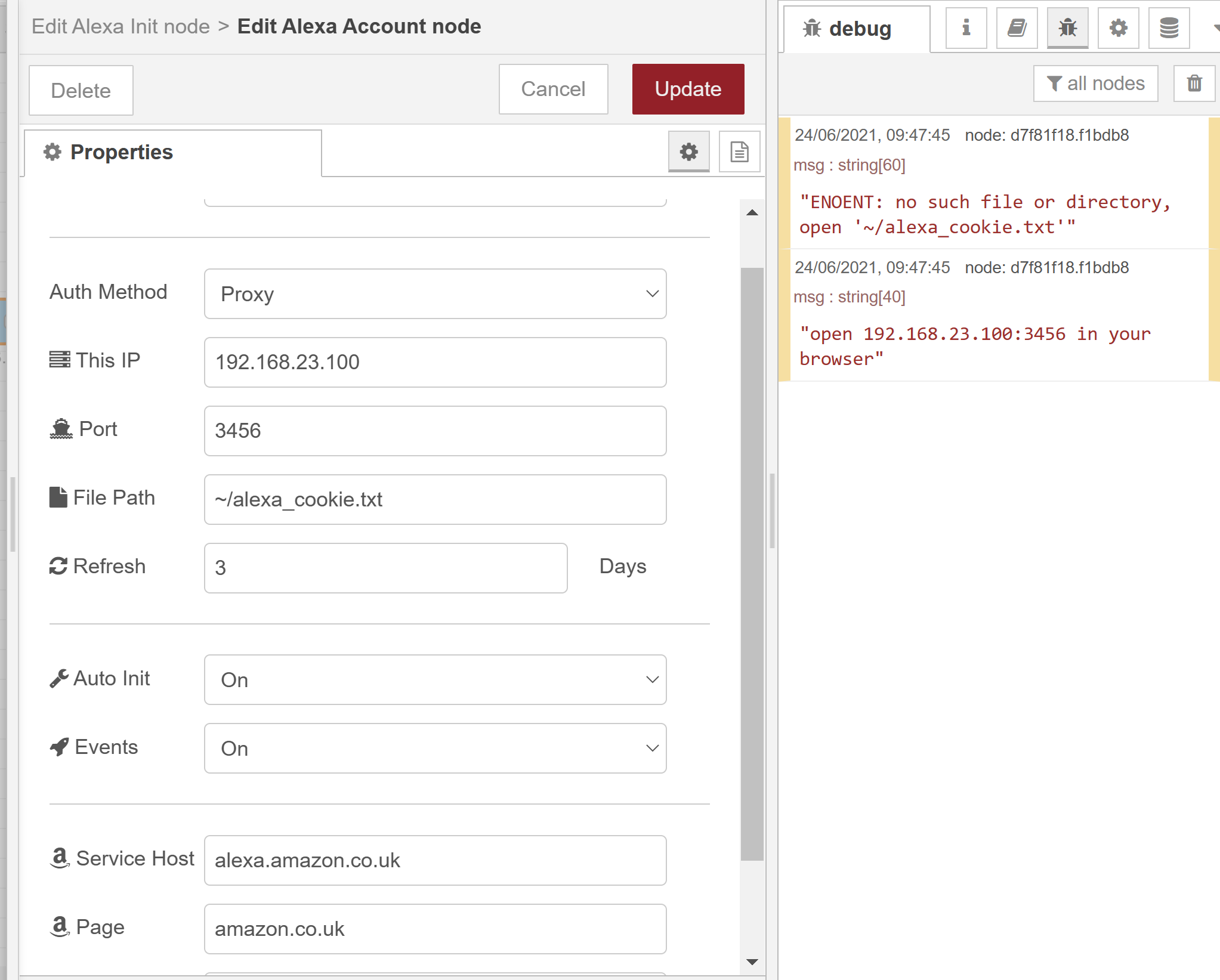

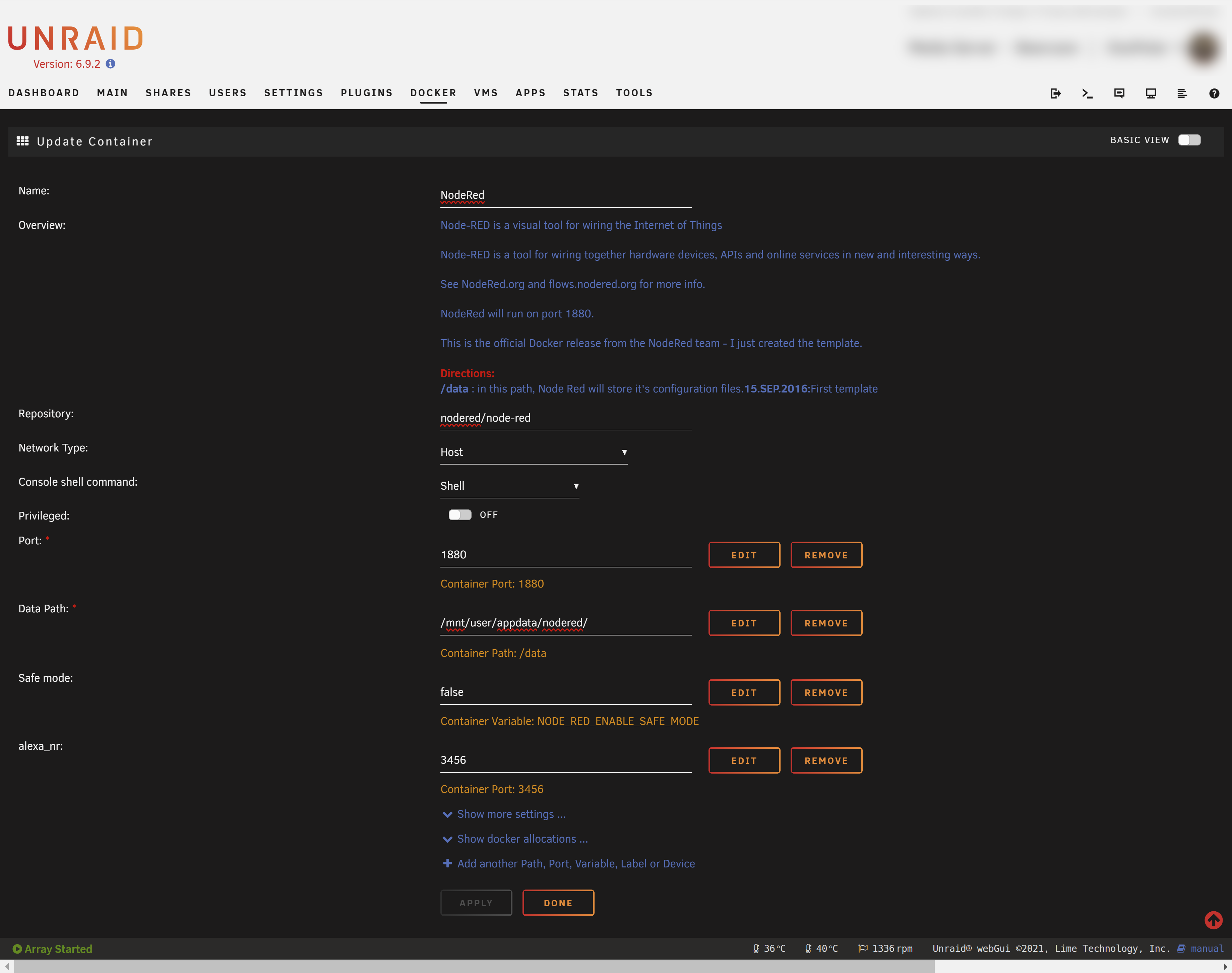

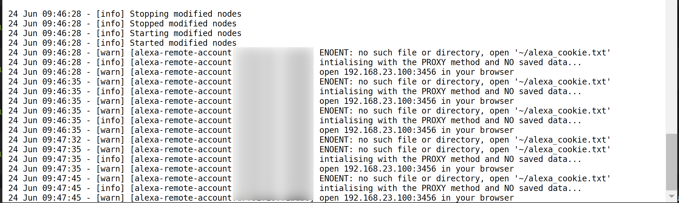

HI Guys i setup a Node Red Docker last night on main PC and added an additional port to get access for my Alexa Pluging with a local IP http://192.168.23.100:3456/ and i could get to page and login to authenticate alexa cookie
It keeps kept confirming with Alexa the cookie was saved.
But NR kept reporting i needed to do it again it would not connect?
Please use a location for the cookie to be something like this:
/data/AlexaAuthFile.txt
It will then save it in your appdata directly and not the container.

try setting the permissions of the appdata directory for node red
chmod 755 /mnt/appdata/node-red (or whatever you have called it)
