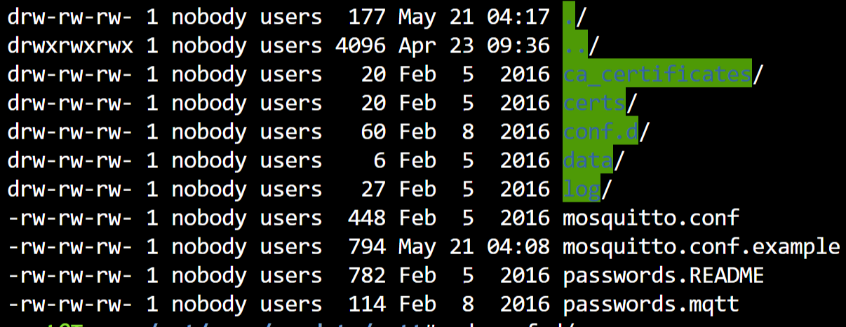

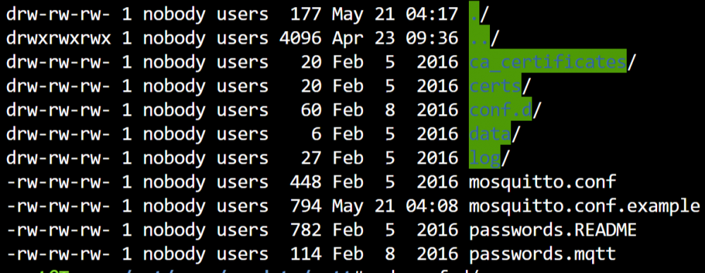

After updating Unraid to 6.10 today, I was unable to start MQTT.
1653129413: mosquitto version 1.4.8 (build date 2020-01-27 00:25:20+0000) starting
1653129413: Config loaded from /config/mosquitto.conf.
1653129413: Error: Unable to open pwfile "/config/passwords.mqtt".
1653129413: Error opening password file "/config/passwords.mqtt".
1653129593: Error: Unable to open log file /config/log/mosquitto.log for writing.
1653129593: mosquitto version 1.4.8 (build date 2020-01-27 00:25:20+0000) starting
1653129593: Config loaded from /config/mosquitto.conf.
1653129593: Error: Unable to open pwfile "/config/passwords.mqtt".
1653129593: Error opening password file "/config/passwords.mqtt".
I have probably 25 other dockers that didn't have an issue. I've had this MQTT docker installed for years and never ran into this. I checked the GUI UID in the settings and they're proper. I did attempted to do a chown -R, but that was unsuccessful. I am also unable to access the mqtt folder through the Windows Network share on a remote machine on the network. I can access any other folders. I find this a bit strange, any ideas? I have a lot of things that run through MQTT, so it is quite important to get back up and running.

if you shell on to unraid can you see the directory?
can you use the filemanager plugin to see if the files are there?
You might have to CHMOD -r 777 (or just RW privs) on the mqtt app directory (beware of the consequences!) as unraid changed the permissions/owners for appdata a while back
Let me know how you get on.
I use 6.10 with lots of mqtt clients with this. I should really get around to looking at building a more modern mqtt broker and template....
Edited by spants
@spants Yes, they are all there. I have done everything suggested in the forum/thread here.
I'm quite stumped on this. I'm thinking of nuking the whole thing. Deleting the image and the appdata folder for MQTT and installing again from scratch.
I don't think there is much in the folder itself that would need to be saved. Without persistence, I think it would just be the mosquito.conf and the passwords.mqtt. I could manually open those with nano and copy the contents.
Edited by live4soccer7
Yes you could do that. I had to CHMOD my directory as the persistence db wasnt saving.
Just rename it after stopping the docker.... and then restart. You may have to set the permissions on the new directory.
Edited by spants
That did the trick. There was quite a bit more in the .conf file after re-installing it. The config page for the docker also didn't show the PUID GUID either. A few changes. I've had the same install probably not long after you initially released the docker.

When I go into the command line, I can see the files within the appdata folder for the docker are owned by multiple different users, including "root" , "nobody", and my personal username.
My question is, which user is the best-practice owner for these files in node red? I'm having some difficulties figuring out how to order the item that they said was the error in bash, so I was also wondering if it is ok to just do chown -R within the command line for the folders within the appdata folder?
Set all the files to be owned by user nobody and group users. I had this issue with my Node-RED container as well and that fixed it for me. None of those files should be owned by root (which is why you got that error telling you that). Most containers for Unraid use nobody:users.
chown -R nobody:users /mnt/user/appdata/node-red
So I did a reïnstall of MQTT, because the container is very simple to setup. At first deleted the container and the app data folder, the installed the docker again.  When i did the following command:
ls -all /mnt/user/appdata/MQTT
It did gave me this result:
With this I was not able to acces the files in code server or smb share.
Then I did the following command:
chown -R nobody:users /mnt/user/appdata/MQTT
After a reboot of MQTT I get the following permissions:612287407_permissions2.png.f9c925389da21631a57f0532e7177431.png
When I checked the log file of MQTT I could see the error was still there:
1656662227: Saving in-memory database to /config/data/mosquitto.db.
1656662227: Error saving in-memory database, unable to open /config/data/mosquitto.db.new for writing.
1656662776: Error: Permission denied.
When I tried to acces the share to code server or smb it was still not able to acces it:
I have other shares with the same permmisions which are accesaible.
MQTT is working, but I'm worried about these issues.
