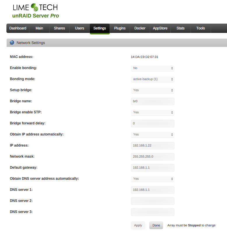

My Network settings are attached, for reference. I have two nw cards but I am only using one.
Thanks!
Tony

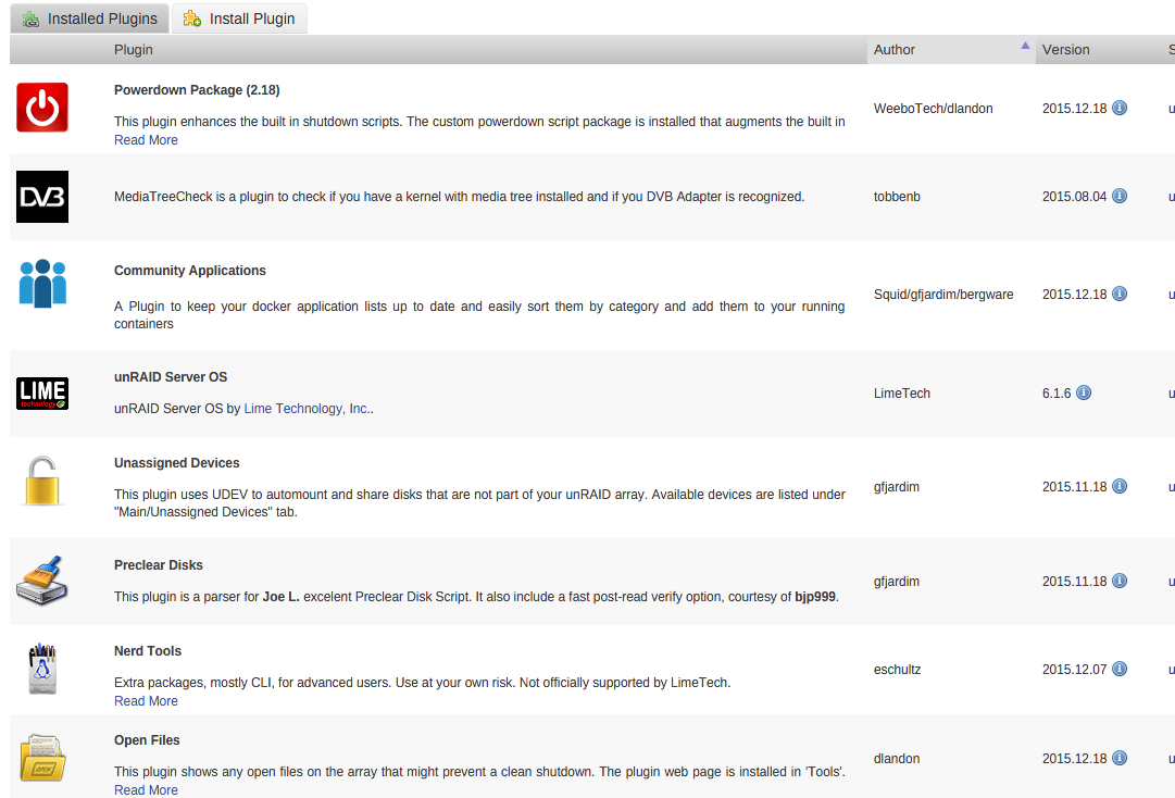

I wonder whether it's a plugin causing the issue rather than another docker container, but not sure which one yet.
It could be - I'm only running a few non-standard ones.
