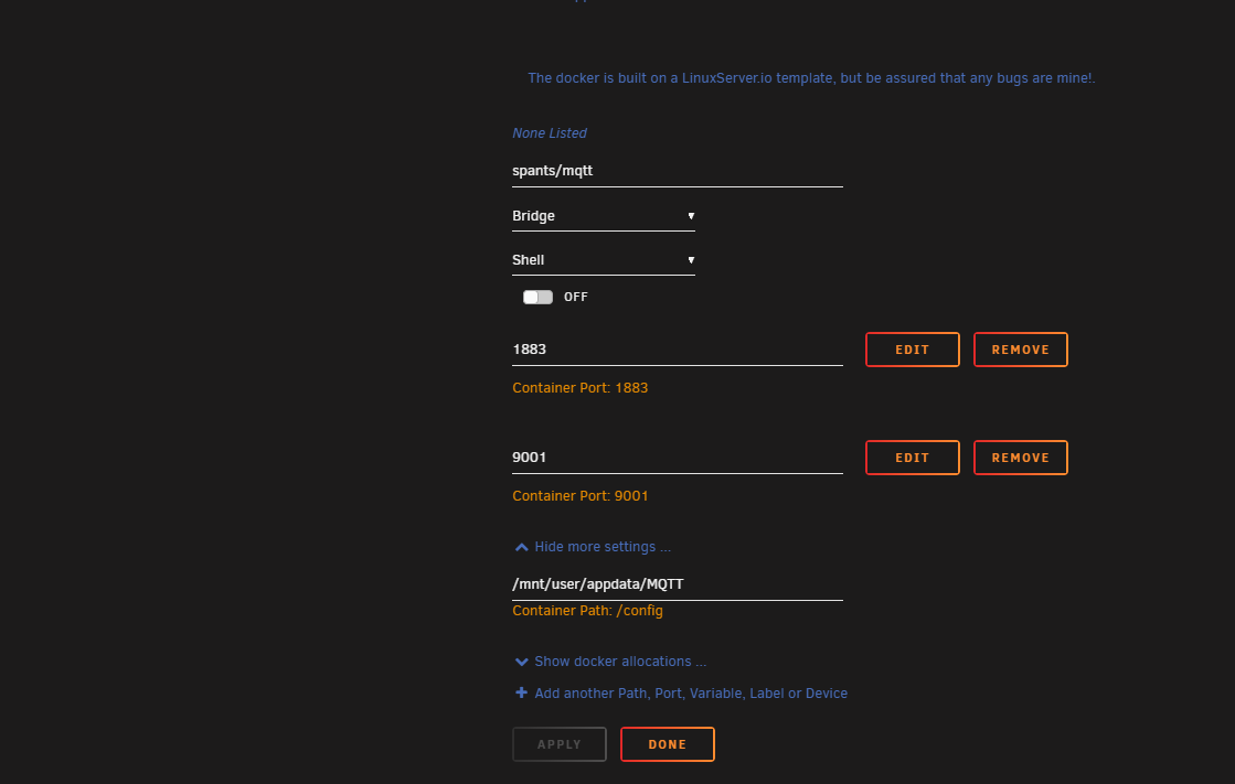

Anyone seen this from the log?
 1738585922: Saving in-memory database to /config/data/mosquitto.db.
1738585922: Error saving in-memory database, unable to open /config/data/mosquitto.db.new for writing.
1738585922: Error: Permission denied.
My config:

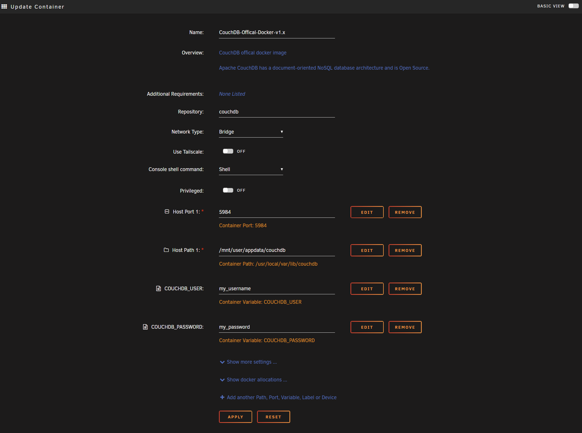

On 10/14/2023 at 2:11 PM, camens said:
You just have to add COUCHDB_USER= and COUCHDB_PASSWORD= as variables in the docker setup.
1. Click on the container and click 'Edit'
2. In the Update Container window, go to the bottom and click '+ Add another Path, Port, Variable...'
3. In the Add Configuration window that pops up, change Config Type to variable, set the name and key to 'COUCHDB_USER' and the value to your username. Click Add.
4. Repeat step 3 for COUCHDB_PASSWORD.
5. Click Apply
My config:
6.12.14
Run the following commands inside the container
find /config -type d -exec chmod 775 {} \;
find /config -type f -exec chmod 664 {} \;
chown -R mosquitto:mosquitto /config
The problem is run.sh inside the container has this line chmod -R 666 /config which messed the folder permissions up.

17 hours ago, Jurykov said:
I'm still on the spants MQTT container, but when I set the protocol version to 5 in home assistant it fails to connect. I think both need to be changed in order to make it work. I considered migrating to the official Mosquitto docker, but was working on other stuff today. Looks like I have some time to figure it out though based off the error from home assistant.
I see the following when it's set to 5, but nothing in the system logs to tell me exactly what's failing. Works when set to 3.1.1 though.
i do not beleive the SPANTS one supports version 5 is the issue.
