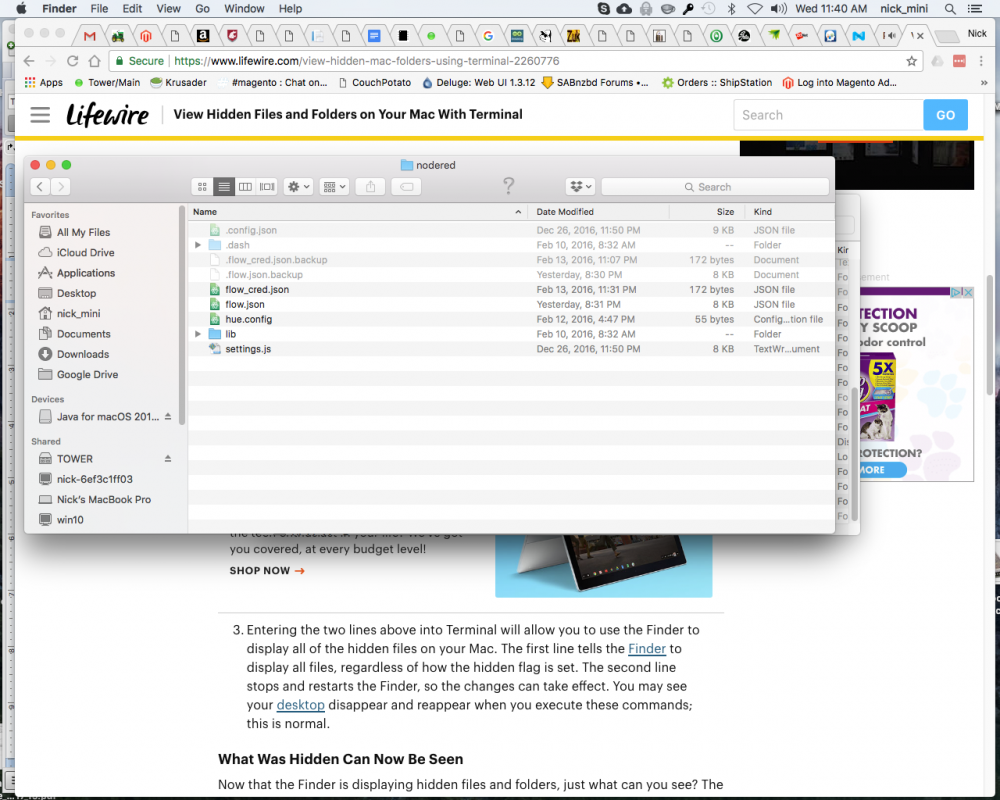

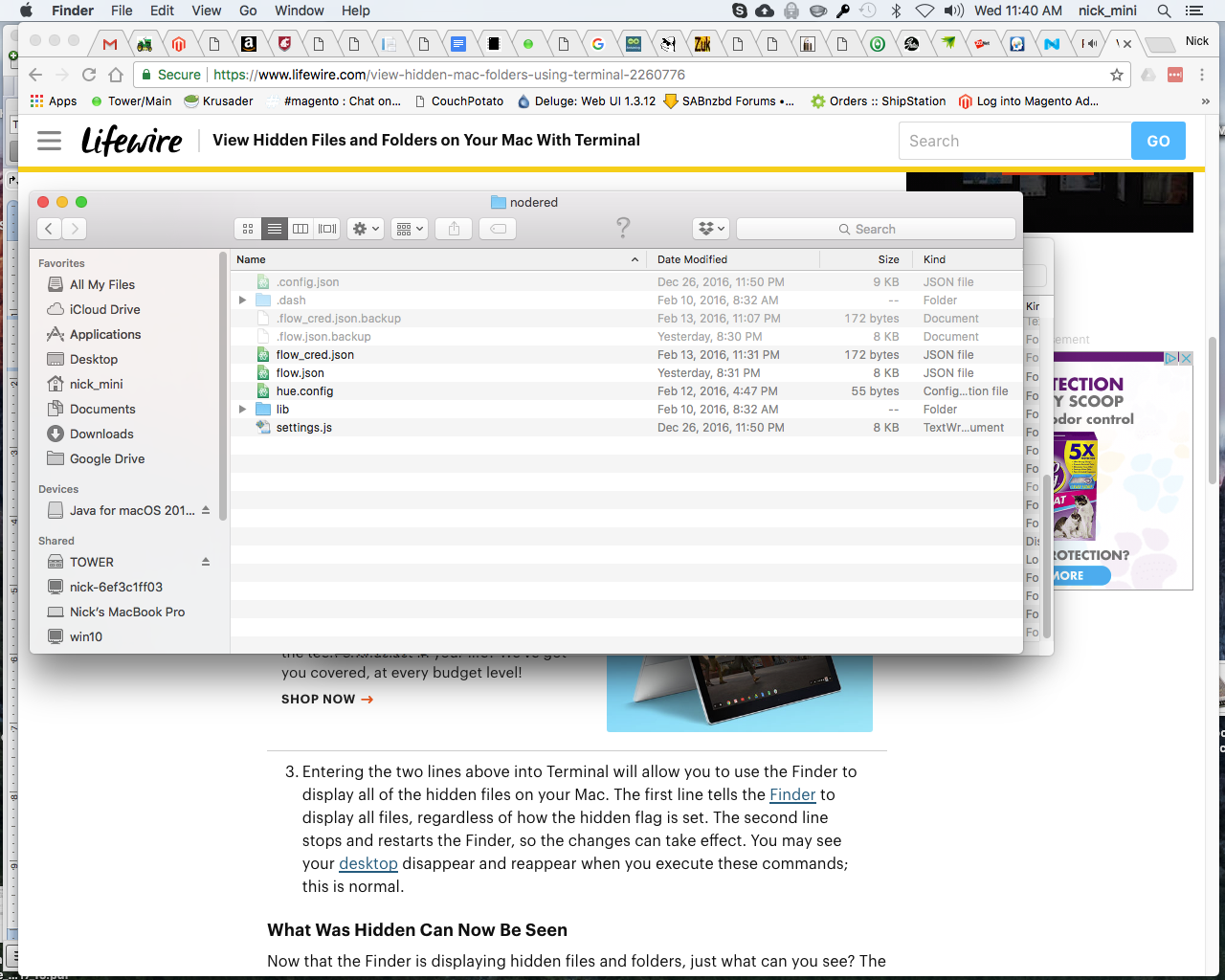

Here is a screenshot of the files I have in my NodeRed folder

change flow to flows for each.... (keep a backup)
ie to:
flows.json
flows_cred.json
Edited by spants

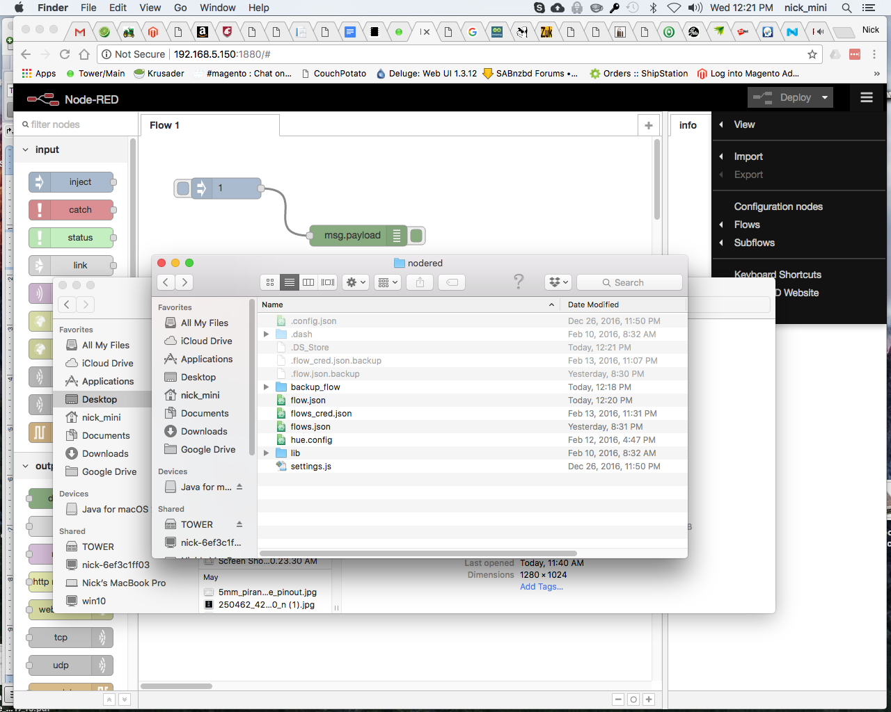

I did that and i was able to create a flow that actually worked, simply input in to debug.
My old flows are not there anymore (kept a backup). It seems that nodered created another flow.json even when I changed it to flows.json.
I have also taken a screenshot of the import area and what it does.
5a2851f8055fe_ScreenShot2017-12-06at12_21_58PM.thumb.png.ddbba4ae6d437d3e810aa6e56940d8e9.png

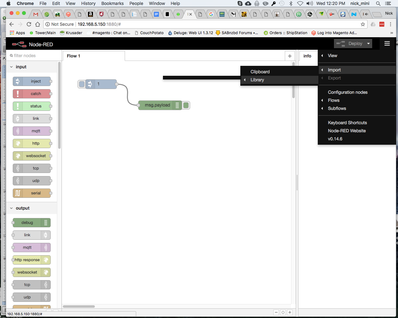

5a2851d37d551_ScreenShot2017-12-06at12_20_48PM.thumb.png.06e3dfce31d479057f9e3ee559092c5e.png

I got it updated. How do I import new libraries? I figured I would go to Menu -- Import -- Library --- Choose file. Do I need to put the file in the docker directory first for it to show up there? It has been so long since I did this that I can't recall what I did back then.
Manage palette is how you add new nodes.
