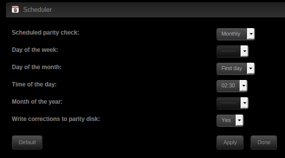

Scheduled parity check didn't run
I'm not sure why, I just checked the scheduler again, and it's set to run on the first day of the month, but it hasn't run.
In checking, i tried to use the back button on my browser, and saw an error message at the bottom of the window, which seems to be related, but I've no idea how to fix it.
Also, this problem still exists :(
Have you updated to one of the new betas recently? If so, did you re-enable the scheduler?
Yes, I'm on 14b, and yes, I did check the scheduler, and it still appears to be set, as per the screenshot I attached.

I reset it to run in about 10 minutes.  I'll keep my fingers crossed.  My thumb drive is installed on a usb connection on the motherboard, so I have to take the cover off the server to get to it.  not a huge deal, but still :(
Your screen shot does NOT show that the Scheduler service is actually running.
Okay, but it is.
It started.  Not sure what the problem was, but it does seem to be working now.
