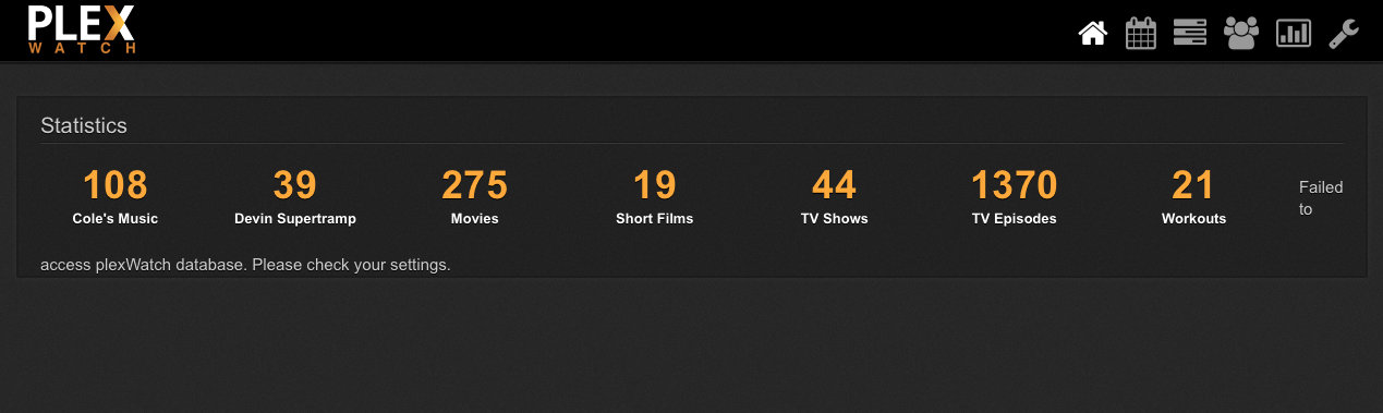

PlexWatch Docker - failed to access plexWatch database

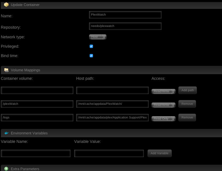

Just installed PlexWatch in a new docker from needo/plexwatch. I have tried everything. It is running in host mode. Plex however is still a plugin because it running the latest Plex Pass version and I can't find a docker with that version. I have literally tried EVERYTHING. Even permissions of the database its self.

It can access Plex fine but not it's own database.

As for plexWatch I ended up running Plex and plexWatch both in 'host' network mode, and then updated the plexWatch docker to use my own version: esvinson/plexwatch:latest  (template url: https://github.com/esvinson/docker-containers/tree/master) which defaults to port 8082 so it doesn't conflict with SABnzbd using port 8080.
My PlexWatch volume config:
/logs -  /mnt/user/appdata/plex/Library/Application Support/Plex Media Server/Logs/
/plexWatch - /mnt/user/appdata/plexWatch

•If plexWatchWeb loads, but gives a "Failed to access plexWatch database" error message:
?Login to Plex and go to Settings -> Server -> Connect. Verify that the account you are signed in as has a Plex Pass.
?Start watching a movie, wait a few minutes, then try accessing plexWatchWeb again.
