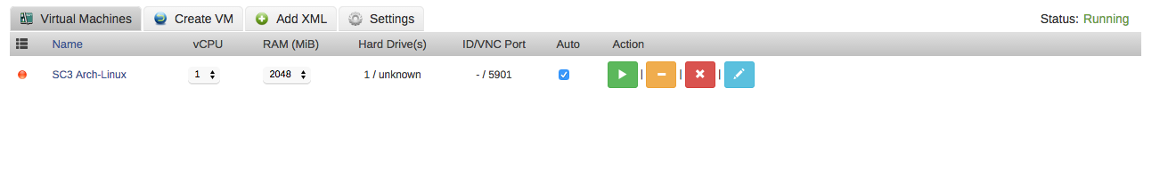

So I managed to get the arch-linux package that is from Appliances section of this forum doing something....
But now I dont know if it is even working correctly, or how do I access the machine?
Thanks
Thanks
Mouseover the buttons and see if it tells you what they do.
Hi, thanks sorry should have mentioned I did that. When I click "Start Domain" the page refreshes and nothing else happens.
Still have the red/orange ball beside the Machine name that says "shutoff" when I mouseover.
If it refreshes and it doesn't start then there is an error somewhere.
