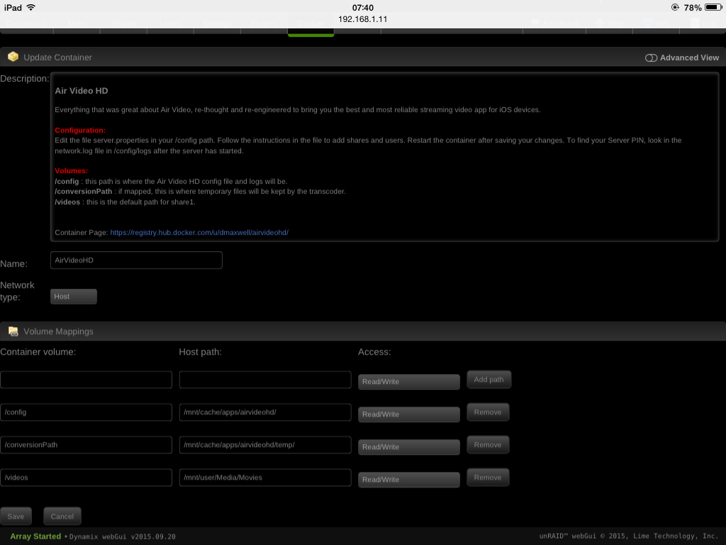

I seem to be having a bit of trouble with the volume mappings to my video files with this. I can get access to the server and I can see my video folder "Movies" but there are no files contained within.
I have tried copying the volume mapping from the normal AirVideo as obviously nothing has changed and that just works. If I click on the volume mapping from the docker page for AirVideoHD it will take me to my videos so I am really struggling to understand what I am doing wrong.
Shrimpyaab's post helped massively in getting connection and so forth just stumped as far as the rest of it is concerned.
Any advice gratefully received
Thanks
What are your volume mapping locations and also the share locations in the properties file for Air Video? They need to be the same.
Hi Shrimpyabb
I have attached some screenshots of the docker and the properties file.
Your shared path in the properties file needs to match the container volume, not the path.
sharedFolders1.path = /videos
You don't have to use "videos" either. As long as they match. I have one for /tv and one for /movies.
Restart Air Video HD for changes to take effect.
Fantastic you were absolutely correct.
Its working now thank you ever so much for your help, so grateful for your input.
You're welcome!
I'm glad it's working now.
