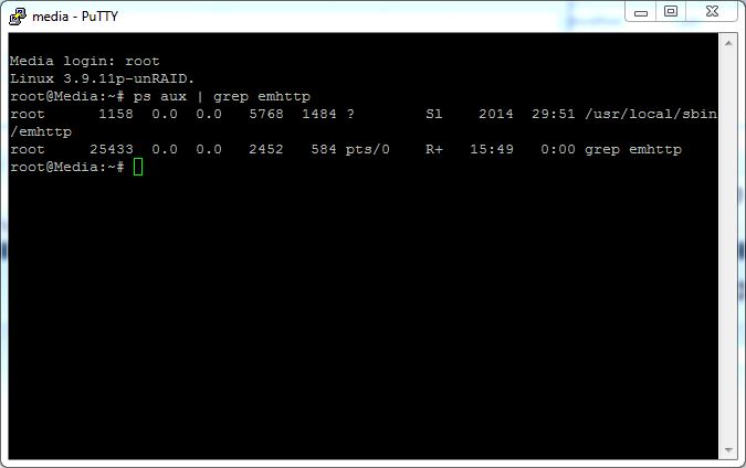

Post the result of this from telnet:
ps aux | grep emhttp

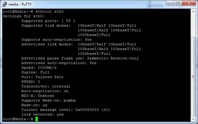

Also, to see what your unRAID thinks of your connection
ethtool eth0
ps aux | grep emhttp returns:
root              1158  0.0  0.0    5768  1484  ?            S1      2014        29:51  /usr/local/sbin
/emhttp
root            25433  0.0  0.0    2452    584  pts/0      R+    15:49          0:00  grep emhttp
for ethtool eth0, please see attachment.

Your results above showed that emhttp, the web interface, was still running, and that you have full duplex GB connection. You probably already guessed that.
