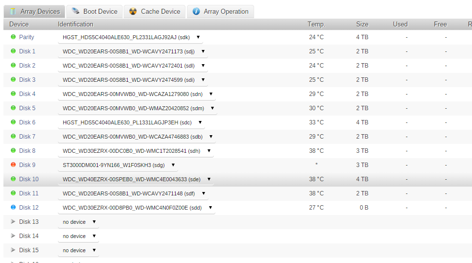

Hello,
After some serious problems with my array I finally got the system stable only to find a drive Red Ball on me.  I had a spare 3TB drive though so I threw it in and for some reason unRAID is detecting the drive at 0B.
See the screen shot attached.
I have run preclear on this drive it passed with flying colours.  Any thoughts?

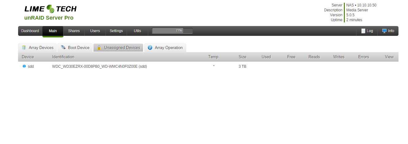

When I try and put the 3TB WD Green in place of the Red Ball drive I get this error on the "Array Operations" tab: The replacement disk must be as big or bigger than the original.
So just to try something I turned the array on and left the new drive unassigned.  When I went to the unassigned tab the drive is showing up as 3TB now.
So frustrating.  What am I doing wrong here?

Often a slightly smaller disk means an HPA. I have explained it many times. Search for it.
Agree it may be a Host Protected Area (HPA).
There are several ways to resolve these.    I prefer to simply boot to an HDAT2 CD (free) and use the "SetMax" function to automatically reset the drive to its native size.
