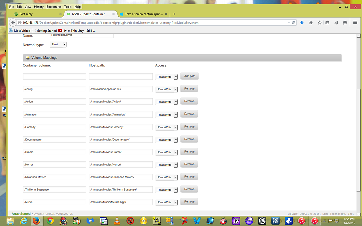

this is my plex volume mapping
I can't quite make it out, but your host paths look like this: /mnt\user/Movies....
They should all be forward slashes.. (But, very hard to read with it resized)
they're all set forward slash
Perfect..  Just the way it looked from resizing.
