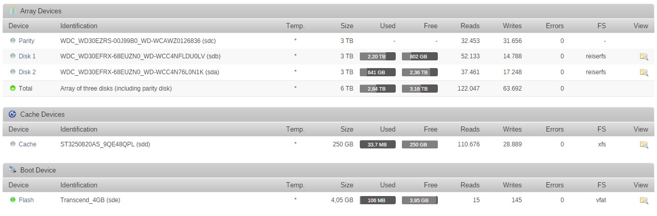

March 6, 201511 yr Hi I'm planning to move to XFS while i have the storage available to do so. I posted a screenshot so you can see the current setup and so you can understand what i'm talking about. Solution 1: Right now i could move everything from Disk2 to Disk1. Then format Disk2 to XFS. Then move everything from Disk1 to Disk2. Then format Disk1 to XFS. But this would leave me with a full Disk1 and not evenly split between the drives. Solution 2: Make the Parity Disk to Disk3. Move everything from Disk1 and Disk2 to Disk3. Format Disk1 and Disk2 to XFS. The move everything from Disk3 to Disk1 and Disk2 to let the data evenly split. This is what i'm just thinking, i really don't know what the best way is. I read this: http://lime-technology.com/wiki/index.php/Transferring_Files_Within_the_unRAID_Server So i know about the commands to use. I'm thinking of using the "cp -r /mnt/disk# /mnt/disk#" command locally on my server because it's safer to copy then to move. After the copying process, i would just have to delete the content after verification from the drive i copied? Please guide me trough this process, i'm planning to do this in the coming week as i'm getting a new mobo+ram+cpu.
March 6, 201511 yr Community Expert Hi I'm planning to move to XFS while i have the storage available to do so. I posted a screenshot so you can see the current setup and so you can understand what i'm talking about. Soloution 1: Right now i could move everything from Disk2 to Disk1. Then format Disk2 to XFS. Then move everything from Disk1 to Disk2. Then format Disk1 to XFS. But this would leave me with a full Disk1 and not evenly split between the drives. There is nothing wrong with this approach but as you say it requires that all the data fits on one disk, and also if you want the data more evenly split then once both disks are in XFS format you would need to selectively copy data back from the full disk to the one with more free space. Solution 2: Make the Parity Disk to Disk3. Move everything from Disk1 and Disk2 to Disk3. Format Disk1 and Disk2 to XFS. The move everything from Disk3 to Disk1 and Disk2 to let the data evenly split. Nothing wrong with this approach either. It solves the problem of not having enough free space to get all the data off one disk by temporarily using the parity disk as a staging area. As long as you format disk3 as XFS then at the end you can make it one of the two data disks, and use the last emptied data disk as the parity disk going forward. Note, however, that when you have finished if you want to put disk3 back as a parity disk that unRAID does not give you an easy way to reduce the number of data drives in use. You would need to run the 'New Config' option from the Tools menu to wipe the current disk assignments and then reassign the data and parity disks. Data already on the disks survives this process. You need to be very careful at this stage that you get the assignments right as accidentally assigning a data disk as a parity disk would destroy its contents. So i know about the commands to use. I'm thinking of using the "cp -r /mnt/disk# /mnt/disk#" command locally on my server because it's safer to copy then to move. After the copying process, i would just have to delete the content after verification from the drive i copied? If you decide to use the 'cp' command then you need to add the -p option to preserve permissions and owner of files. If you do not you would need to run the New Permissions at the end. I personally prefer to use 'rsync -a' instead of 'cp -rp' as if you get interrupted rerunning the command skips files already successfully copied, while with the 'cp' command it does not. You also have the option with rsync to add a --remove-source-files parameter to remove files after they have been successfully copied (although it does NOT remove and empty directories left behind).

March 6, 201511 yr Author Okay i have read what you all have to say about this, first of all thank you for taking your time and help me! So my conclusion based on everything you have said so far: I will go with solution 1 which seems like most of you preferred/recommenced. I also decided to skip the process of splitting the content evenly because as eventually as "bjp999" said, if i continuously add data (which i do) the disks will eventually be evenly split. So now that i know which process i will follow now the matter is about which command to use. I read about what you have suggested but i'm really new to this stuff. So if i got it right i would use this exact command locally on my server "rsync -a /mnt/disk2 /mnt/disk1" to move everything from disk2 to disk1. Then format disk2 to xfs. Then use "rsync -a /mnt/disk1 /mnt/disk2" to move everything from disk1 to disk2. Then format disk1 to xfs. If i wrote the commands wrong then please correct them. And also, using this command, can i see like a process-bar with percentage or do i need to check the disks manually from "Network" on my PC?

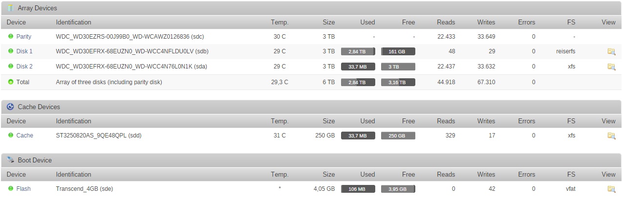

March 9, 201511 yr Author So i done with one drive using this command: "rsync -av --progress /mnt/diskX/ /mnt/diskY/" I have verified and check the data that was transferred, everything went smoothly without any errors. But i will not be transferring to the XFS drive just yet because this transferred made my CPU fan spin at 5400RPM. I have the NAS in a storage-room but the fans were spinning so loudly you could hear it even though the door was closed to the room. My new MOBO+CPU+RAM that will arrive this week runs with a passive cooler and much lower TDP. This will be the new set: http://www.zotac.com/products/mainboards/integrated-intel-cpu/zotac-nm10/product/zotac-nm10/detail/nm10-dtx-wifi/sort/starttime/order/DESC/amount/10.html Also checking out some smaller mITX cases as i my current setup is a mATX with Fractal Design Node 804 case.
