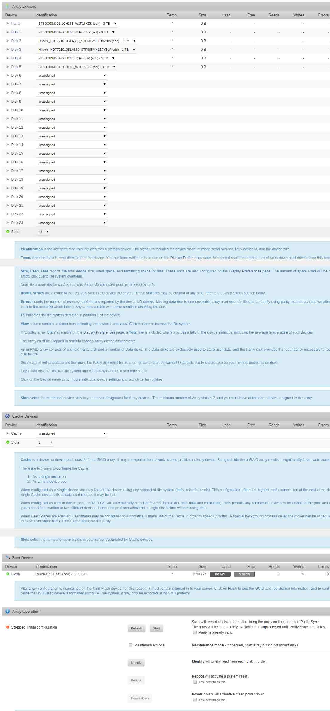

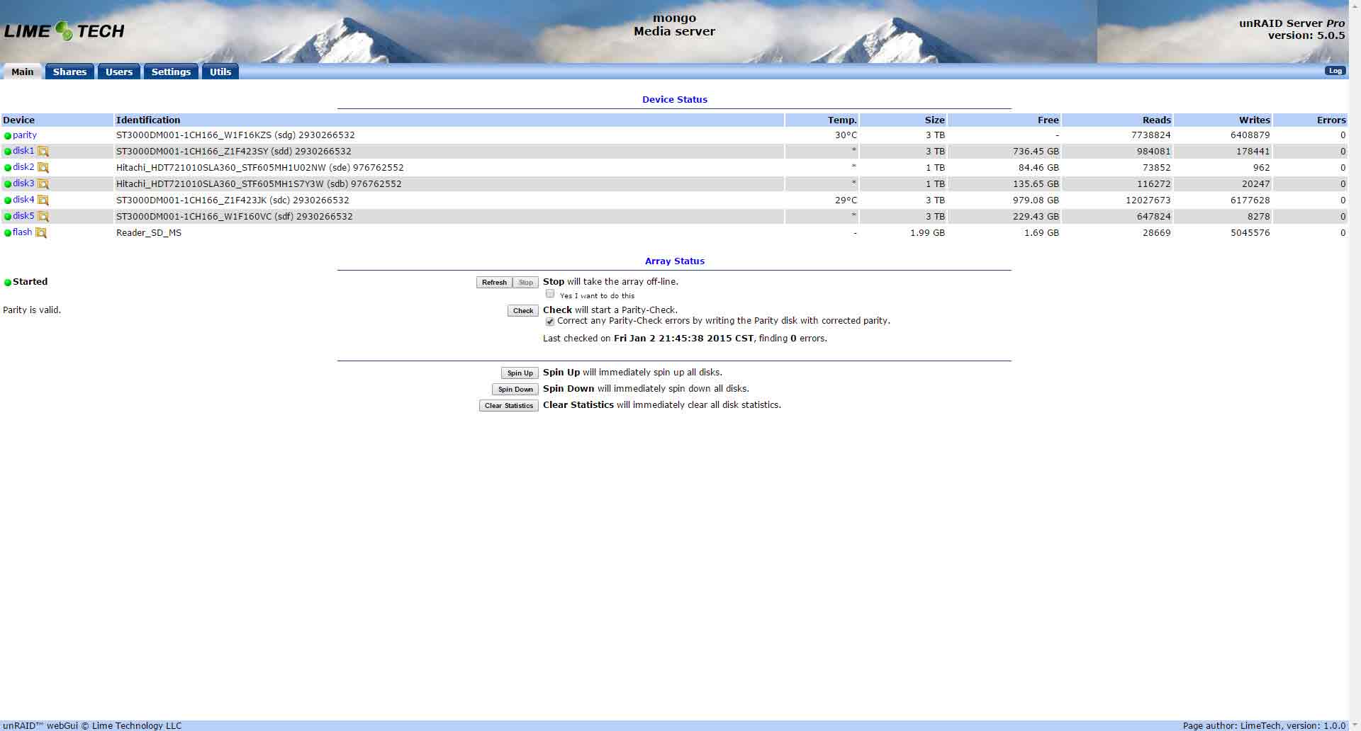

I just did a fresh install of Unraid 6 after being on Unraid 5 for years. I moved all my drives into a new build and I've assigned them exactly how I had them before. But is says "initial configuration" on the array instead of "valid array" or whatever.
See attached images.
What do I do to make sure I don't lose all my stuff?
Can I just check "parity is already valid" and start the array? Or will this set it up as a new array?
I got antsy and just checked "parity is already valid" then hit start. It seems to be working now. Just doing a parity check.
