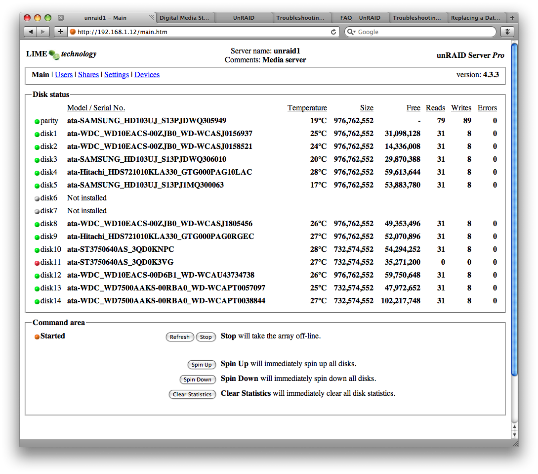

Here is what is happening: This week a write error error apparently occurred.
A red ball appeared next to one of the two Seagate 750gb drive I have in my unraid as pictured below:

Your case is a perfect example of why we are more and more strongly recommending a complete parity check before any major change to the array, such as your drive rebuild.  It would almost certainly have found the issue with Disk 10, that stopped the rebuild.  Fortunately, the problem with Disk 10 appears to be just a cabling issue, not a drive problem.  (That may also be true of the drive you removed, since you saw no serious drive errors on the SMART report.)  A cable problem could be either a defective or loose SATA or power cable or splitter, or defective or poorly seated backplane.
Disk 10 was disabled early, and that resulted in all of the rest of the errors.  That killed the rebuild, as you can't rebuild without all other drives being perfect.  The new Disk 11 is showing serious Reiser file system damage, which is completely understandable since it was not fully rebuilt, and the ReiserFS module crashed, causing a message about emhttp being 'tainted', which probably explains the loss of web page.  You do NOT want to run reiserfsck on Disk 11, because it still needs to be fully rebuilt, from the beginning.
I think your safest option right now, is to re-install the previous Disk 11, and then run the Trust My Array procedure, to fully restore the array.  It will start a parity check, which you should allow to finish.  Expect to see parity errors, but it will be correcting them along the way.
Once it finishes, might want to run a second parity check, just to prove everything is fine.  Then, if you wish, you can again replace Disk 11, and start a rebuild.
I do recommend you replace the cables to both Disk 10 and Disk 11, with the best quality cables you can find.
Very minor point:  Disk 10 (sdj - ata-ST3750640AS_3QD0KNPC) appears to still have its SATA150 jumper installed.  See the Improving unRAID Performance, Remove SATA150 Jumper section.
