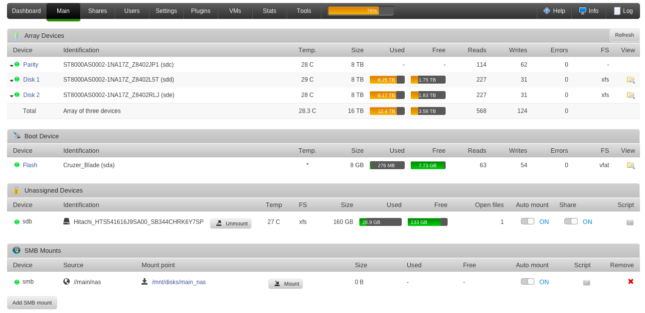

First bit of feedback:
From my Backup Server I mounted the "nas" share on my Main Server. Notice that it did not grab the Size, Used or Free variables.
See screenshot.
See screenshot.
It will only appear when you mount it.
See screenshot.

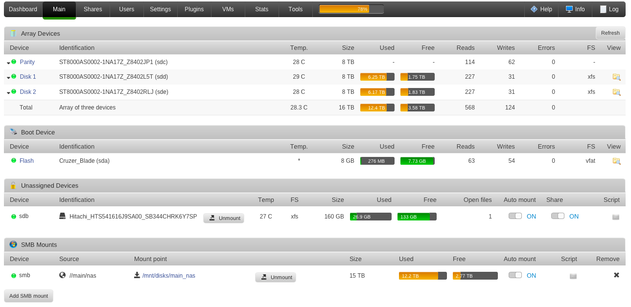

What a knob. I forgot the first time I have to click mount. Working perfect.

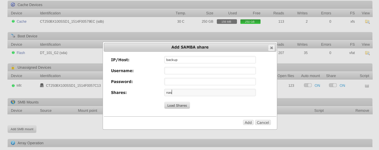

Using user/password? The Add SMB Mount popup worked fine?
Nah - I don't use userid and passwords for shares on my servers so I didn't enter anything into the credentials fields. But it worked fine without.
EDIT: Here is a screenshot of the popup working great (without userids and passwords) on Safari Version 8.0.6 (10600.6.3) on Yosemite.
