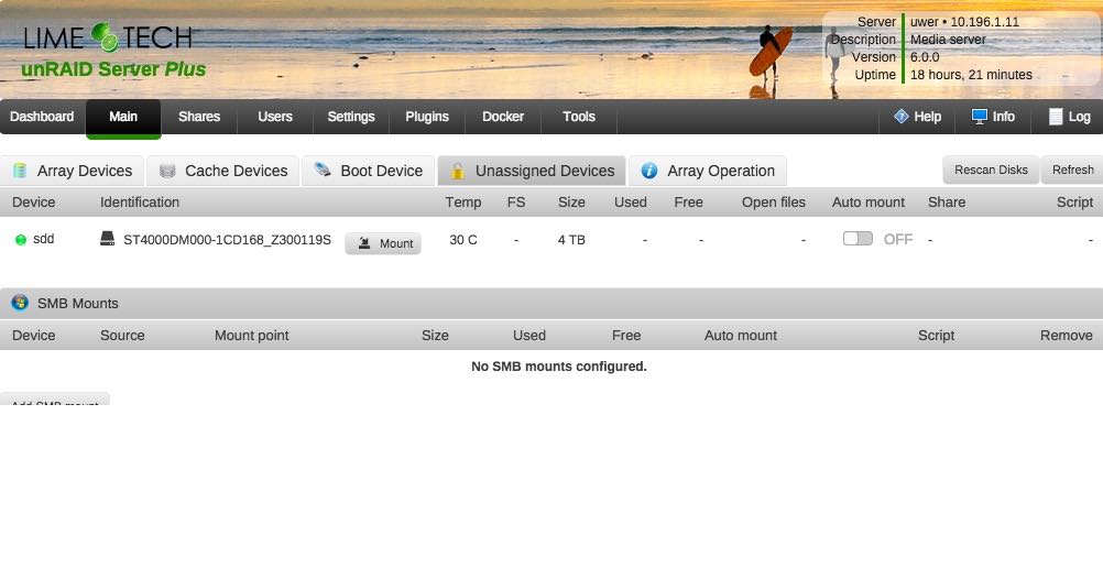

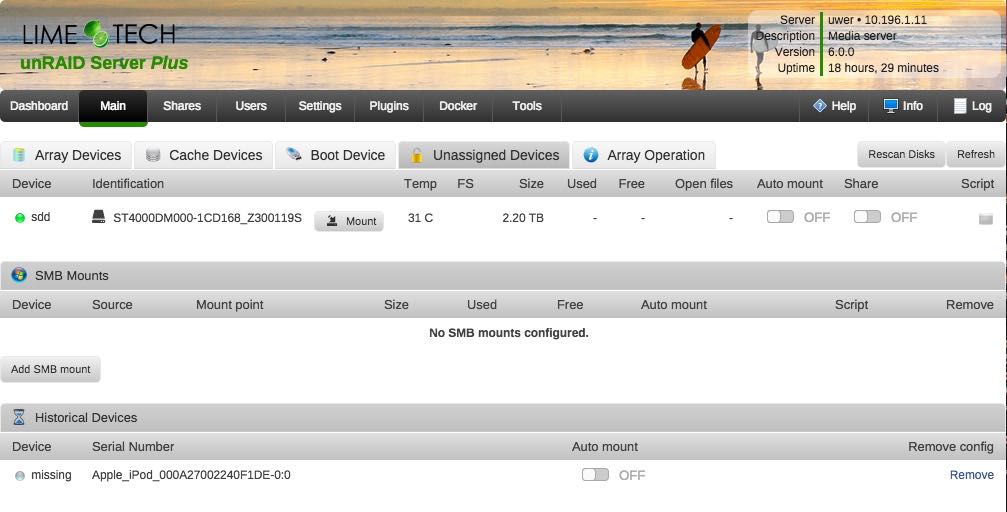

I have a precleared 4TB drive that also shows a disk size of 2.2TB. Like mr-hexen wrote in another post, df -h does not show any information on the disk because it is not mounted. Here is some other information on the disk:
root@uwer:~# lsblk /dev/sdd
NAME   MAJ:MIN RM   SIZE RO TYPE MOUNTPOINT
sdd      8:48   0   3.7T  0 disk
??sdd1   8:49   0     2T  0 part
root@uwer:~# blockdev --getsize64 /dev/sdd
4000787030016
root@uwer:~# blockdev --getsize64 /dev/sdd1
2199023255040
root@uwer:~# /boot/custom/preclear_disk.sh -t /dev/sdd

This is a very odd behavior; the lsblk and the blockdev commands work fine when reading the disk, but not when reading the partition. I'm unable to debug this right now, since I don't have a spare 2TB+ hdd around. If anyone found a solution, please let me know.
A precleared disk >2.2TB doesn't really have a partition on it. It has a "GPT Protective MBR" but it doesn't have a GPT. The block tools interpret it as a MBR partition of maximum size.
In reviewing this plugin code I see the partition size is reported in the disk row when there is only one partition. I would change it so that the disk row always reports the disk size. This would fix the disk size, but would leave a confusing 2.2TB partition listed.
You could also get really fancy and detect a valid preclear signature, note it in the FS field and not show any partition.
