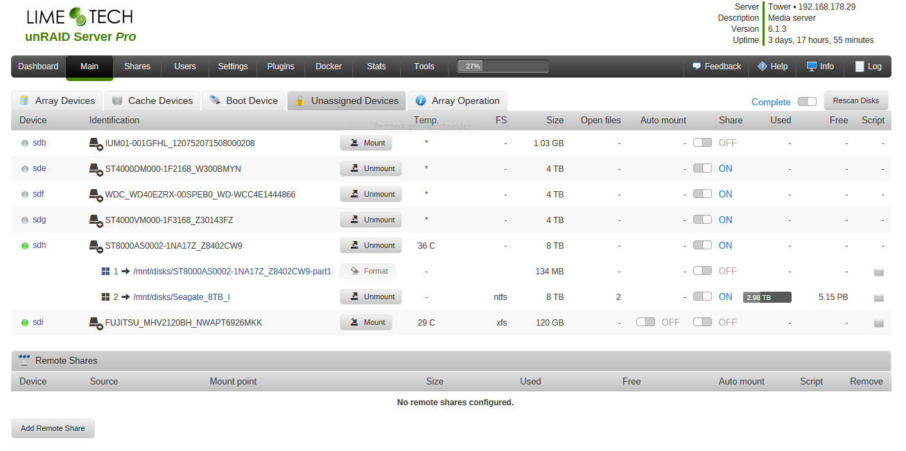

i got a small cosmetic problem with unassigned devices - see the attached screenshot. It seems the template for the table has an extra "-" entry for the automount switch. Also the free space on my 8tb drive is given in pb instead of tb - probably a overflow error. See the attached screenshot. Otherwise the plugin is working great!
regards,
Videodr0me

Need some help. Can you please let me know how can I mount a Mac OS Extended (Journaled) drive? I am trying to copy some large amount of data over to server that is on a mac formatted drive.
I've just installed a new SSD and the 'Format' button is disabled. I opened a terminal, formatted as btrfs and mounted all manually, but the plugin then doesn't show the drive as mounted. Would prefer to format and mount via the plugin - any ideas?
Go to Settings, Unassigned Devices and change Destructive Mode: to Enabled
I mounted a mac drive connected directly via sata. It mounted ok, but I ran into trouble with errors by doing lots of renaming, deleting and changing permissions (newperms) on the drive. I'm not sure if the drive was corrupt to begin with or whether my extensive I/o on the drive caused the problems. I'll copy the data via smb in future!

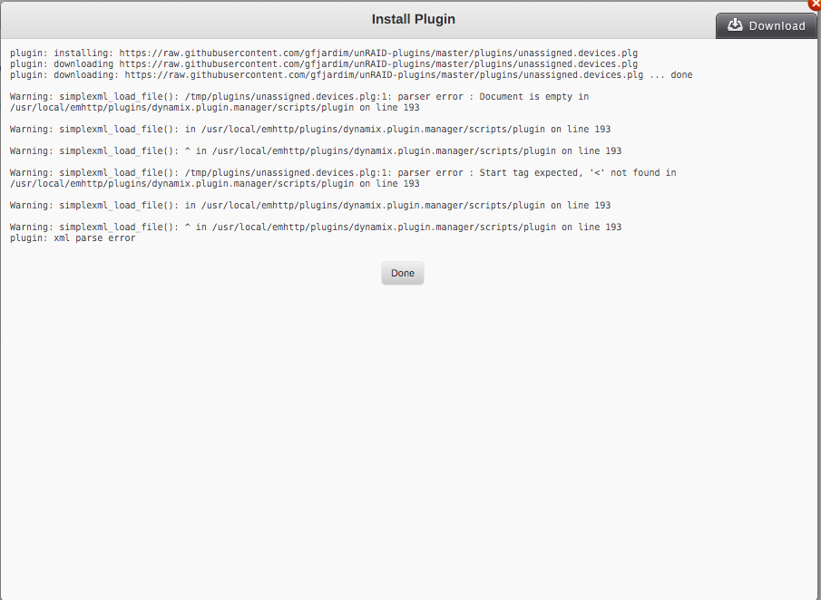

Update:
I tried reinstalling to see if it would happen again, and now I get an error message as in the attached screenshot...
I am thinking now there is nothing wrong with the plugin.  I found my web UI was blank on the array page and I noticed on running commands from a shell I was getting "no space left on device" messages".  I didn't see any filesystems that were full and memory was not fully utilized, so not sure what the problem was.  I rebooted, and the plugin installed without any issues.  Must be something that occurs overnight...
