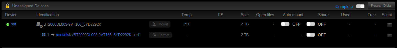

Trying to get a 2TB drive mounted with Unassigned Devices. I plan on using it for DVR software Blue Iris running in a Windows 10 VM.
When I first added the disk to Unassigned Devices it had already been formatted as NTFS. I was able to mount and share the drive no problem. I pointed Blue Iris at is and was getting errors that it could not write. I manually copied some files to the share and this worked fine.
My next thought (I should state I am really new to UnRaid and not a Linux guy yet) was to create a image on the the disk and mount it as a local drive in the VM. This was not an ideal solution as it locks the records to the VM only but better then having to write out the array and constant party writes it would generate. Windows saw the disk as unformatted (expected) so I tried to format it. When I do this the format hangs at 0% and the Unraid GUI stops responding. Everything else seems to continue to work. The only option I could find was to reboot the server to get the GUI back. I repeated this a couple of times to confirm it was the format causing the hang.
Next thought is the disk was not formatted properly. so following the commands earlier in this thread I tried to format the disk.
gdisk /dev/sdX
  o
  n  (taking defaults)
  w
mkfs.xfs /dev/sdX1
Now I cannot mount the disk I a greyed out mount button and a greyed out format button (see attached).
Any thoughts on getting this disk formatted for a share for a Windows 10 VM?
Again I am new so be gentle (or at least thorough). Let me know if I can provide anything to help troubleshoot or find a solution!
Many thanks in advance!
Mike

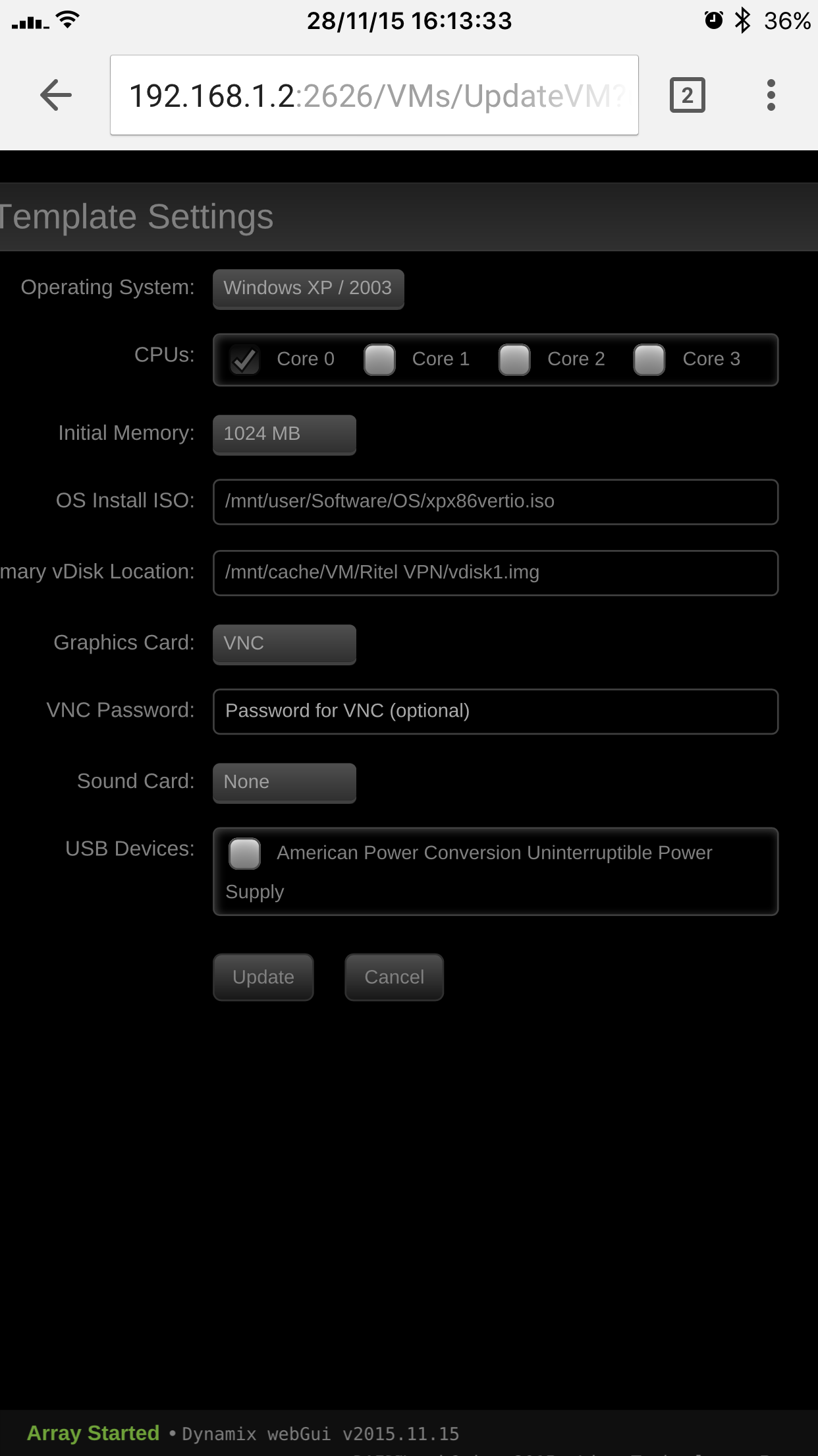

Why not just pass the disk into the VM then share it from the VM if you need network access
Sounds like a great plan.. Just trying to figure out how to do that :-) I don't see an option with the VM to pass disks. Just images. Still reading/searching..
Stop VM
Edit VM
On the bottom in USB DEVICES, check your drive
Start VM
Profit!
Looking forward to the profit part!
I don't see anything in the USB part but the USB Keyboard dongle that I have. No other devices appear there. To be sure the plugin "unassigned devices" was not taking possession of the drive I removed it. I see the disk listed under unassigned on the main page, but not as an option within the VM. I am searching how to do this. Seems like the right answer, just need to figure out how :-)
Thanks!
Mike
***edit
For what its worth the drive is a SATA drive attached to the motherboard that I am trying to use.

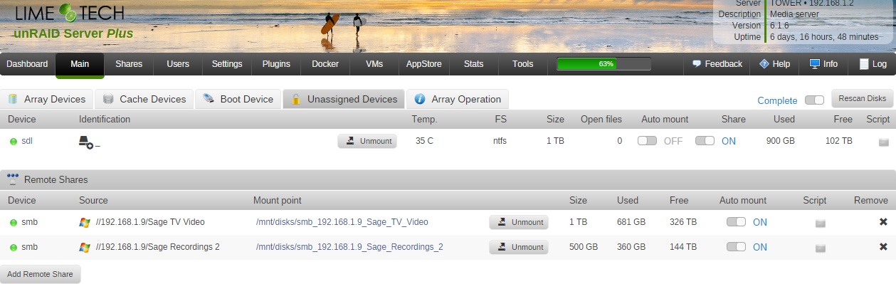

I'm new to this plugin. Trying to use it on my 6.1.4 unRaid to add a disk that I got from a friend (it has content and he claims it was formatted as NTFS).  The disk shows up in Unassigned Devices but there is no Mount button :
https://www.dropbox.com/s/uilwyrsc1r2dux5/Unassigned%20Devices.png?dl=0
fdisk -l for this disk gives this :
Disk /dev/sdc: 4000.8 GB, 4000787030016 bytes
256 heads, 63 sectors/track, 484501 cylinders, total 7814037168 sectors
Units = sectors of 1 * 512 = 512 bytes
Sector size (logical/physical): 512 bytes / 4096 bytes
I/O size (minimum/optimal): 4096 bytes / 4096 bytes
Disk identifier: 0x00000000
   Device Boot      Start         End      Blocks   Id  System
/dev/sdc1               1  4294967295  2147483647+  ee  GPT
Partition 1 does not start on physical sector boundary.
Any idea how to mount this disk?

Pretty sure you have to use gdisk, not fdisk, on a GPT drive.

I have two smb shares as well as a NTFS disk mounted showing strange free space in the hundreds of terabytes (I wish!) is this a bug? It seems to make sense if it's gigabytes. I have attached a screenshot.
Seems like a bug. I suggest you post in the unassigned devices plugin thread.
