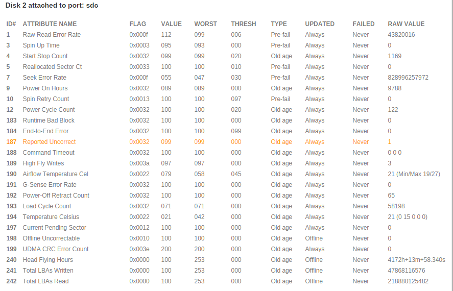

Post the output of the disk attributes screen (click on the disk in Main, then hit disk attributes)
I have attached a screenshot of the attribute screen for that disk.
I imagine Raw Read Error Rate & Seek Error Rate being so high is not a good thing.  :P
Curious why these 2 things would not get reported, both of these are 0 for all my other disks in this setup.
Seagate drives report garbage for those values, and are ignored.
If attribute 187 continues to increase I would question the drive's integrity.

If you have an GOOD extra disk the same size (or bigger) then I would immediately let unRAID rebuilt that disk onto the extra. Then, you can run tests on that disk to validate it's health. That could an indication of a bad sector which is a bad thing to have. If the drive checks out OK you can put it back into the array when the new one was going to go.
According to wikipedia, the meaning of that attribute is ...
The count of errors that could not be recovered using hardware ECC
I can only suspect that a second read was attempted and was successful. If not it would have generated a pending sector, because the SMART system would not just allow a known flawed read to the host OS without an error.
I would not freak over this incident. Comparing MD5 is a good idea. Running a NON-CORRECTING parity check or two to see if there are signs of the condition getting worse. None of the ideas presented are bad ideas, but I personally would not pull it from the array based on a single reported uncorrect with no apparent data corruption or further problems. I have a Seagate drive with a runtime_bad_block of 1 that has been rock solid ever since. I would put that in a similar category.
