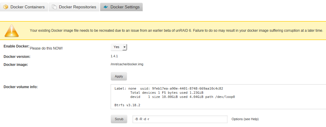

unRAID OS Version:  6 14b
Description: Swapping To New Cache Disk Causes Docker FS Warning. I updated my docker on the next beta after the problem was found. In the process of swapping in different disk (SSD) for cache, I copied docker files to array then copied back to new drive after formatting it.
How to reproduce: Perform Cache Disk Replacement using wiki instructions
Expected results: Since docker was already updated, it should still be good, right?
Actual results: See pic
Other information:
Rerunning re-build of docker clears the error message.
Other information:
This is a known issue due to moving the image to a non-btrfs filesystem and then back again (or to a new btrfs filesystem). The nodatacow attribute is lost because it doesn't apply to xfs or reiserfs. We are working on a fix.
