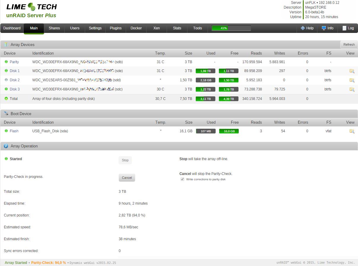

I've just started using unRAID 6, so far it look great but i have a small question about how the "split" work.
I have 3 disks (2x3To + 1x1.5To) in my array (well 4 with the parity one).
I've created a user share with those settings :
  • Allocation method: High-water
  • Split level: Automatically split any directory as required
  • Included disk(s): All
  • Excluded disk(s): None
Now, from a Windows 7 computer I've started a huge file transfer (2.5To) to that specific network share.
The directory consist of lots of directories/sub/files (with sometimes multiples sub-directories).
With the "split any" setting I thought that for any file that would be copied to that share, it would be written to whatever disk was below the "50% mark", but so far it only write to the first disk of the array, and now stats for the first disk are "used :1,68 TB - free :1,32 TB" so it is not above the high water mark anymore, but data are still written to that disk, others remains "spun down".
Do I need the stop my file transfer a restart it again so it will split ? Or did i misunderstood how it is supposed to work?
Maybe I have too many sub-directories ?
thanks!
EDIT: I'm running unRAID 6.0-beta14b.
Quick follow-up :
I tested to stop my transfer, stop/relaunch the array and restart my transfer, now files are written to another physical disk, as intended.
Still don't know what happened at first... if someone have an idea  :)
Thanks for the link, should have search there first.  ::)
it explain why the 1.5TB disk wasn't used, but not why it did not switch to the third disk automatically.
main page screenshot attached below
anyway, thanks for your input !
Maybe won't use the 3rd until it starts using the 2nd.
