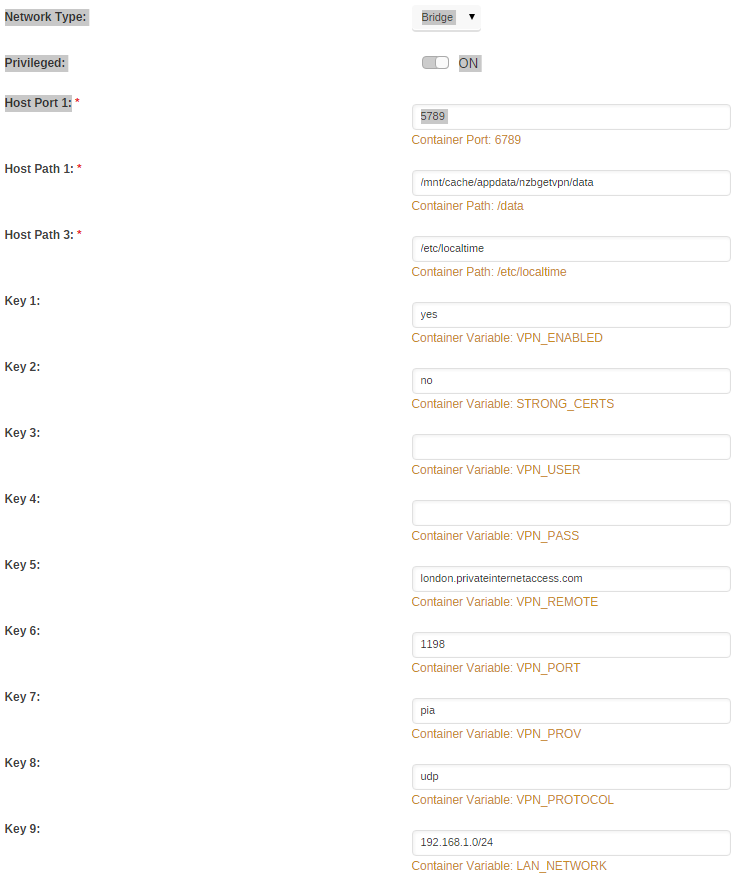

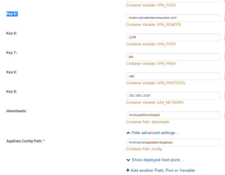

2 minutes ago, Mylo75 said:
Thanks My Settings are
Do you have any other working dockers?
See pics attached as previous post didn't post correctly.
What is your LAN network IP address and subnet mask?
Also try adding in the parameter:
ENABLE_PRIVOXY=no
Sent from my Nexus 5X using Tapatalk
You mean my "tower" ip address, or default gateway
Network mask:
 255.255.255.0
Edited by Mylo75
Either one will work, so let's go with tower ip address
Try changing the VPN address to uk-london.privateinternetaccess.com
No joy. This is from the nzbgetvpn log
