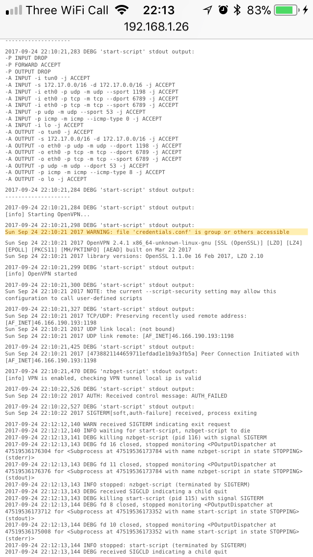

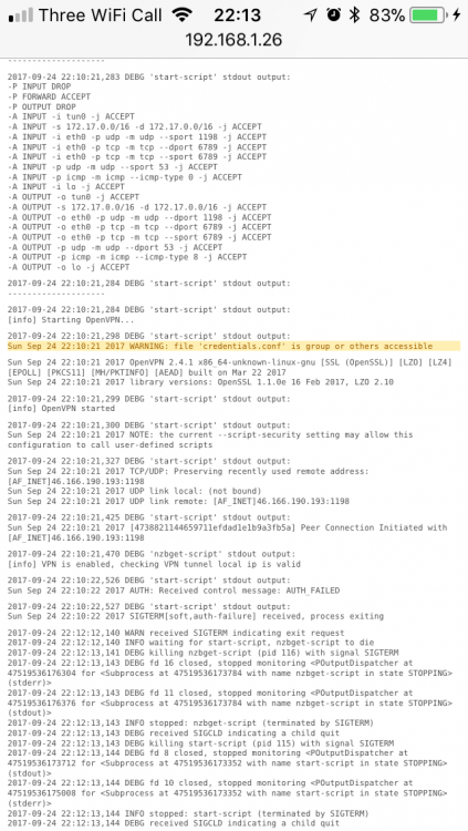

Hi Buggy,
i don’t seem to be able to get into the webgui anymore after doing a couple of settings on the webgui I’m no longer able to get in, I’ve deleted the docker countless times but can’t get back to how it was is there a way to rest it? please help here is my info
1 hour ago, Dazza1 said:
Hi Buggy,
The top of your logs are cut off. What do you have LAN_NETWORK set to and what is your unraid server's ip address?
Hi Bungy, In the settings of nzbgetvpn I’ve got it on 192.168.1.0/26 my server ip is 192.168.1.26 I’ve tried changing the lan_network to exactly the same ip as unraid but still can’t the webgui
Here is the full log

In NZBGet, I enabled CertCheck under Security and now I'm getting a bunch of errors:
ERROR	Tue Oct 24 2017 15:20:46	Could not set certificate store location: error:0B084002:x509 certificate routines:X509_load_cert_crl_file:system lib
ERROR	Tue Oct 24 2017 15:20:46	Could not set certificate store location: error:2006D080:BIO routines:BIO_new_file:no such file
ERROR	Tue Oct 24 2017 15:20:46	Could not set certificate store location: error:02001002:system library:fopen:No such file or directory
Does the NZBGet docker container already have the cacert.pem?

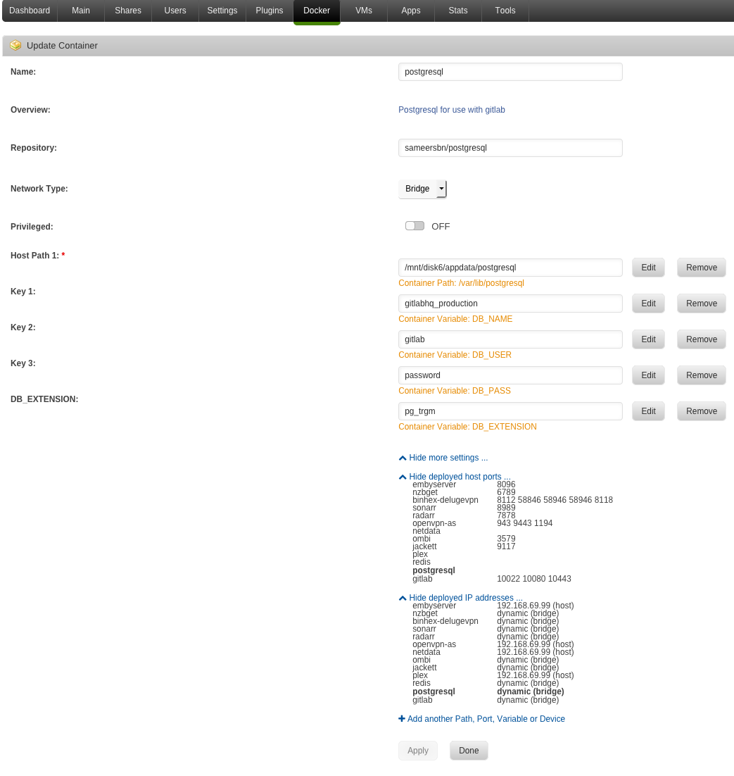

I've tried switching to the sameersbn version of gitlab after having terrible trouble getting the GitLab CE Docker image to work. It worked for slightly less than 12 hours, and then postgresql failed overnight and will not restart:

Why is it trying to initialise the database every time it starts? Surely the logic should be "if the database already exists, use it, otherwise create it"?
I can't see anything odd in the config — the only things I've done are move the /var/lib/postgresql mapping to be on disk6 rather than cache* and add the DB_EXTENSION=pg_trgm.
Does anybody know why this is unstable?
Thanks
* Or is it safe to just point at /mnt/user/appdata/postgresql here? I know the gitlab-ce docker has dire warnings about using cache (too expensive to fill with a massive database) or an explicit disk rather than /mnt/user…
