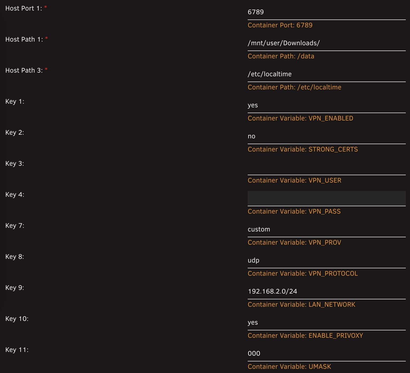

I have a couple of questions as I'm looking to move to this container over the sabnzbvpn one.
**I figured it out myself - see bottom of this post**
1. Will this essentially operate the same way sabnzbvpn does, where I can route sonarr/radarr/nzbhydra via proxy out the nzbgetvpn container?
2. Page 1 of this topic states that you need the following servers installed and running for nzbgetvpn to work.
[*]Redis
[*]Postgresql
Why is that, do they just allow nzbget to work over VPN? Asking as sab didn't require any additional components.

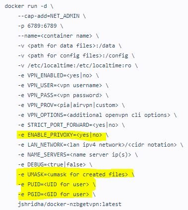

3. On the dockerhub page for nzbgetvpn it show the following options for installation, more specifically those highlighted in yellow.
However, when I install nzbgetvpn from CA, *without Redis & Postgresql installed, I have no options for those highlighted in yellow above. Even after selecting 'advanced view'.
Am I supposed to be creating these variables myself?
I assumed installing this would have been the same/similar as sabvpn, modify/add some variables and change any required locations and we're set. So far, it doesn't appear to be that way, at least not for me.
If anyone can answer or provide any information that would be greatly appreciated.

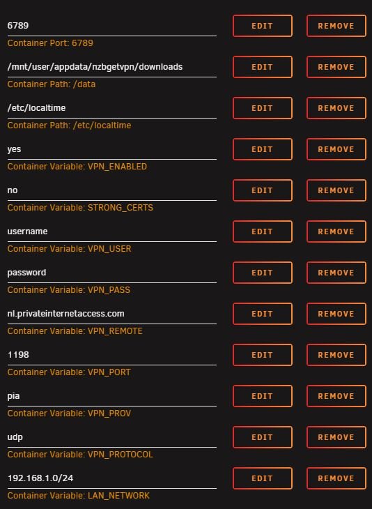

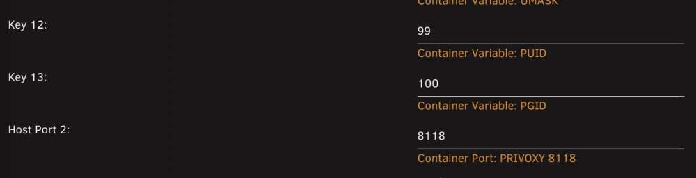

I added all the variables that were highlighted in the first picture. I also had to add Host Port 2, with a value of 8118, which is the port that Privoxy uses.
Since a picture says a 1000 words, here's what my config looks like, VPN user/pass info removed.
I also removed keys 5 and 6 as I didn't need them for this to work.
