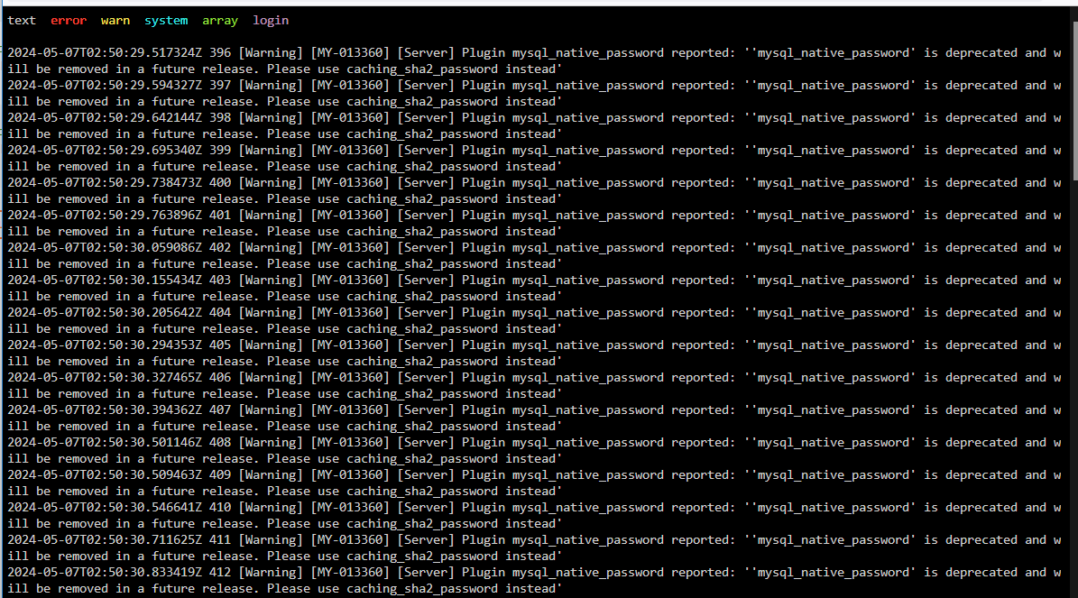

From the Log file----
@Bungy, Any thoughts?
On 5/1/2024 at 4:01 PM, blaine07 said:
I can't get to work even with that argument added - can't remember how I have what setup so I am sure it's a skill issue.
Luckily, in my case, I found the MYSQL_USER name and the MYSQL_PASSWORD in plain text in the KODI .xml file which made it possible to regain access to the stored MYSQL database.   But I don't can't find (or remember) what the MYSQL_ROOT_PASSWORD password was.  So there is no way for me to get into MYSQL to run any commands that would allow me to change how the password is hashed...

I noticed that my mysql container is not working.
All servers and systems cannot access.
phpmyadmin cannot login.
When in the container, trying "mysql status" returns:
ERROR 2002 (HY000): Can't connect to local MySQL server through socket '/var/run/mysqld/mysqld.sock' (2)
I've been hunting around inside the container, and can find no logs, because it appears that the main mysql process will not start.
I'm not sure how this could suddenly happen, nothing changed in my configuration.
Anyhow, I've tried chown on the directory /var/run/mysqld and /var/lib/mysql
I tried to create the sock file manually, that produces no good results just another similar error.
Tried creating a new symlink, that results in an error "cannot access '/var/run/mysqld/mysqld.sock': Too many levels of symbolic links"
Tried deleting and recreating the contaner.
Tried updating to latest (I was using 9.0.1 and updated to 9.1.0.
I'm unsure how to install any tools in this distro, yum and dmf seem to be missing.
I'm pretty stuck at this point, googling and trying to understand.
Can anyone help?
Can anyone help?
A post above noted that people may be having issues with version 9.0+
You can try rolling back to 8.3.0, that worked for me
Another reference here: https://www.reddit.com/r/unRAID/comments/1du4yht/alert_mysql_latest_tag_changed_today_to_9xx/
