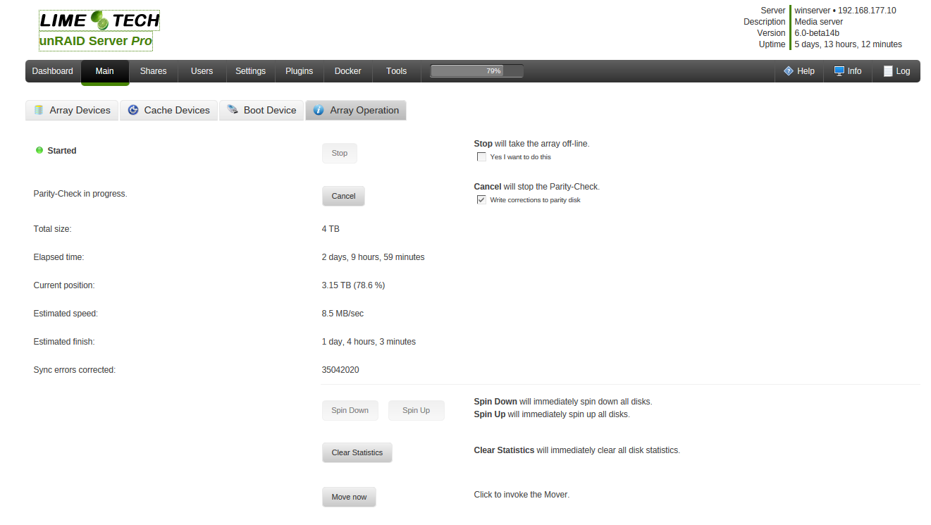

Running latest 6b14. I had a bunch of 3TB drives, and wanted to replace one of the failed 3TB drives with a 4TB drive I had available. Knowing that the 4tb would have to be the parity, I followed the swap-disable procedure, where I pulled the failed drive, left it missing, then reassigned the 3TB parity to be the missing, assigned the 4TB to be the new parity. Then started the array.
Parity was copied from 3TB to 4TB.
Old 3TB parity was rebuilt fine as the missing 3TB drive.
Now I'm running a Parity check, and it went fine up to the 3TB point. After the 3TB point (3TB is my largest data drive), I'm encountering a huge number of parity errors being written to disk.
Is there something wrong? My theory is that the 4TB drive contained 3TB parity information, and the remaining 1TB data was garbage, which now it is correcting. The log doesn't show anything wrong.  Thank you!

I'm not noticing any reads from any of the drives, but a large number of writes to the parity drive. The parity drive seems to be the only one active, and it is SLOW. 8.5MB/s. In the past, as the smaller drives were complete, the parity build/check became faster and faster.
I'll leave this running as is, then do another check immediately after.
Just do not wish this to blow up in my face. Thanks.
Yes - I would definitely expect the parity to speed up once beyond the end of the data disks.
That very low speed is a bit worrying.  I would have expected the parity check to be running much faster at this point.  It is almost as if the system is having some sort of issue with the disk - but there did not seem to be anything in the syslog that suggests this.
It's up to 66,435,555 corrections, and climbing. No errors in the log. Some random other disks spun up, but no activity. Parity "check" is going at 8.5mb/s. :(
