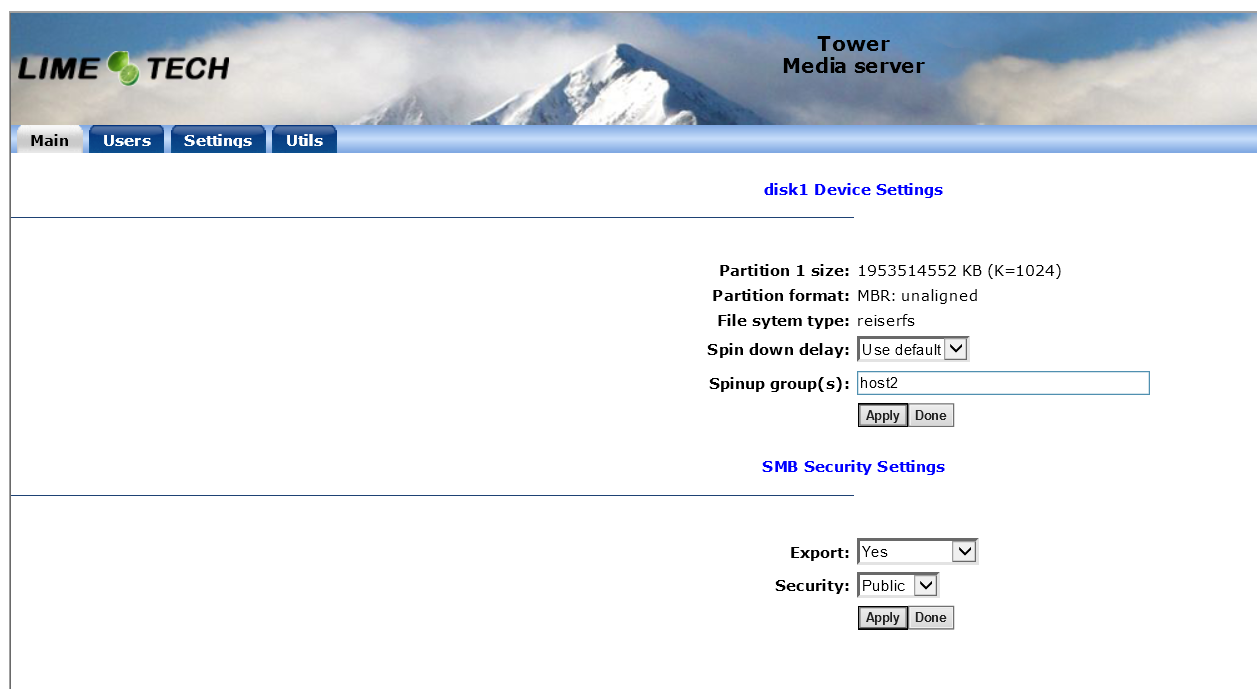

Edit: I've noticed on my old Unraid 5 server, the alignment was set to "unaligned" (with the jumper).
Thanks once again.
Sorry for all the questions, but what was the original reasoning for needing the jumper on WD EARS drives, something to do with Unraid not supporting advanced format drives right?  So now Unraid 6 supports these larger drives, I can remove the jumper, use the default 4k-alignment... do I need to preclear again, or will a simple reformat in XFS take care of things?
It is correct that WITH the jumper the setting is "unaligned", you need to change that to "4K aligned" WITHOUT the jumper. It suffice to do a reformat in XFS, no need for preclear.

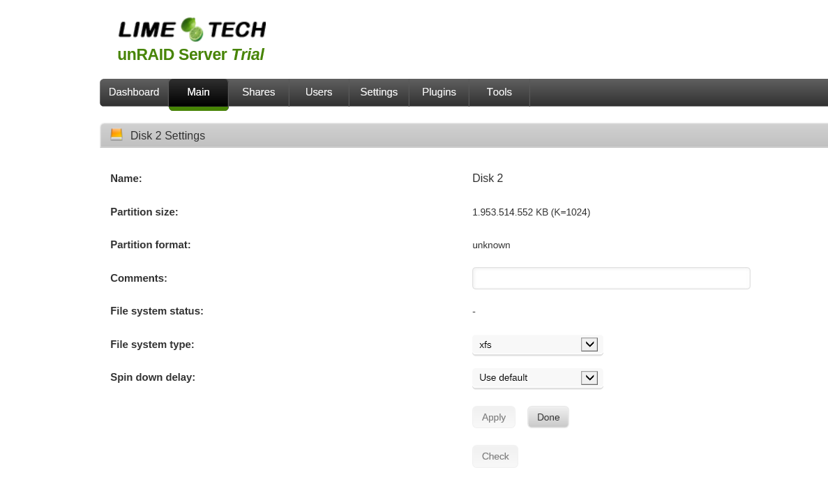

Update on this.  I just whipped the jumper off and chucked the WD20EARS in to my Unraid 6 build.
I am seeing a partition format as "unknown" and no way to set aligned or not (see pic).
I'm guessing this is all in order and I can go ahead and reformat as XFS.  If necessary, will Unraid 5 then read this disk ok later on - assuming I reformat as ReiserFS?
Thanks.
Thanks.
Unclear what you mean by reading the disk, the current contents will be completely erased. Any new content should be able to be read by unRaid V5 as long as it is written to a ReiserFS file system, regardless of partition alignment. Switching partition locations (jumper or alignment) or changing FS from XFS to Reiser will erase current content.
