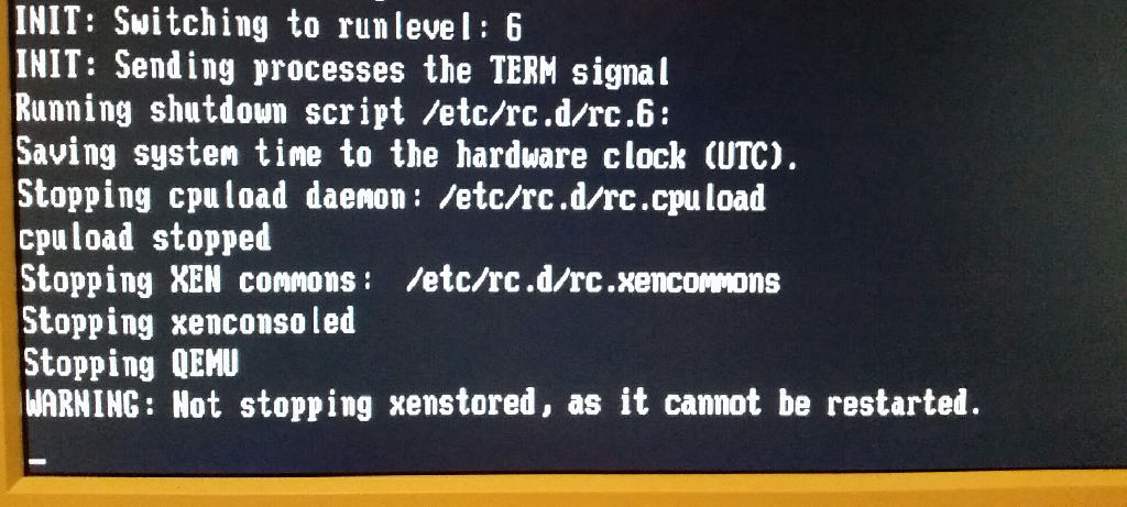

I am running unRAID Server 6.0-beta14b.  I have XEN setup with a Windows 7 VM and a Debian VM.  Both VM's work perfectly.  I installed unMenu, along with the Power down script so that i can reboot the server in the event that the unRAID WebUI crashes.  Even though I shutdown both of my VM's, stop the array, and select Reboot within the unRAID WebUI, the reboot process hangs with an error that says "WARNING: Not stopping xenstored, as it cannot be restarted."  I have attached a pic of my monitor, which shows the error.  The reboot hangs with that error no matter how I attempt to shutdown or reboot the server (WebUI, or Power down script).  I am then forced to hold the power button down and force the server to reboot, which results in a parity check for every reboot!  Does anyone know how to fix this error? Thanks.
Bumping this old thread, as I am still experiencing this issue for every reboot.  I haven't had time to work on it in a while, but was wondering whether or not it has been fixed in later betas or RC1/RC2???  I have searched around, but cannot find a fix.  Surely I can't be the only one that runs XEN with unRAID and has this issue??
XEN has been completely removed entirely in the later betas and RCs. Your best bet is to completely convert away from XEN to KVM.
