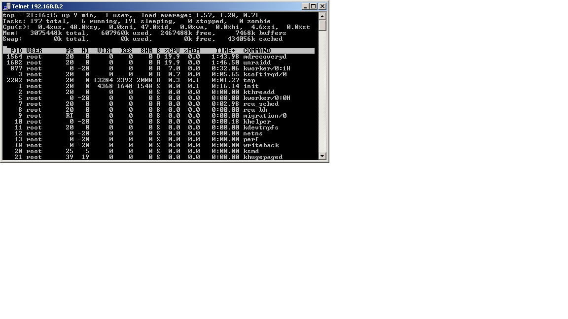

I haven't heard anyone mention the kworker process yet.  The Kworker process seems to be eating my cpu alive when a parity check is running.
Screenshot Attached.  What does this process do?  Anyone have any ideas as to why it would go wild during a parity check?  When I stop the check it goes back down to 0%.
I decided to downgrade to 6.0 b14, and lo and behold parity check speeds are back to normal.  And a screenshot of Top is attached.  And as one would expect with unraid, the CPU is not a limiting factor in the parity check, even though it's a 7 year old single core celeron.
I found out that the kworker process is directly related to things the linux kernel is doing.  So I was very hopeful that upgrading to 6.1 rc1 as alluded to in Squid's post would help me, but it did not.  I saw no noticeable difference between parity check speeds in 6.0.1 and 6.1rc1.
