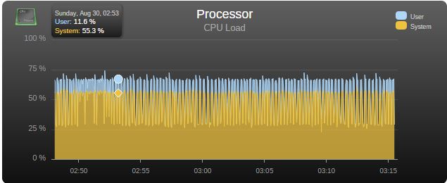

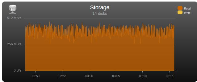

Well, not knowing about this issue, I just bought a SAS2LP on sale this past week and ran right into the problem.  Since people are working on it, I just thought this snapshot was interesting.  here are the charts showing my CPU utilization and Drive speed during a parity check.  My configuration in my signature is current.
I'm not sure that this is useful or not but it seems to be ramping up/down continuously.
