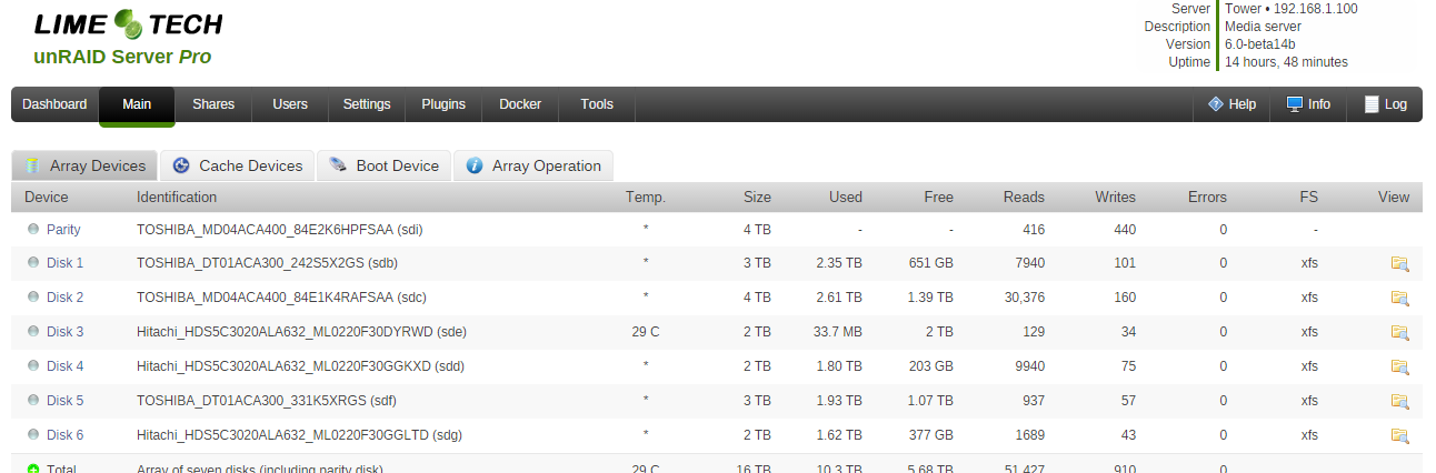

Last week i have finished my conversion of all ReiserFS drives over to XFS.  Since doing that one of my drives, Disk 3 will sometimes continue to report it's temperature to the system long after it has been spun down.  This same drive is also preventing my server from sleeping due to 'disk activity'

even though the default poling time is 30mins, this drive is still reporting temp several hour after everything has been spun down.  Will reseat cable next

Hmm bit at a loss with this. Have rebooted several times, issue usually occurs with disk 3 but a couple of times it affected disk 2.  Disk appears spun down in the GUI but temp is still being reported and s3_sleeps debug shows disk activity to the drive.  Disk 3 has only one file on it so I doubt it is actual file access

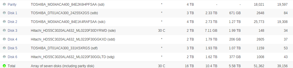

anyway to tell what this Disk activity, the drive shows spun down whilst this message is being logged, but temperature still being reported.
whether it's coincidence or not this drive is almost totally empty, except for the one file i copied to it to make sure i could write to it ok, at what point does the mover decide to start using the drive? all shares are set to high-water i believe
[edit] and for the sake of thoroughness i have swapped my sata cable over
Just had success spinning all drives up and back down again, seems to have reset something.
