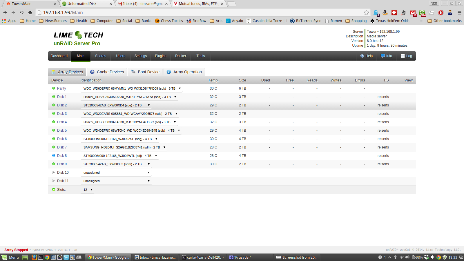

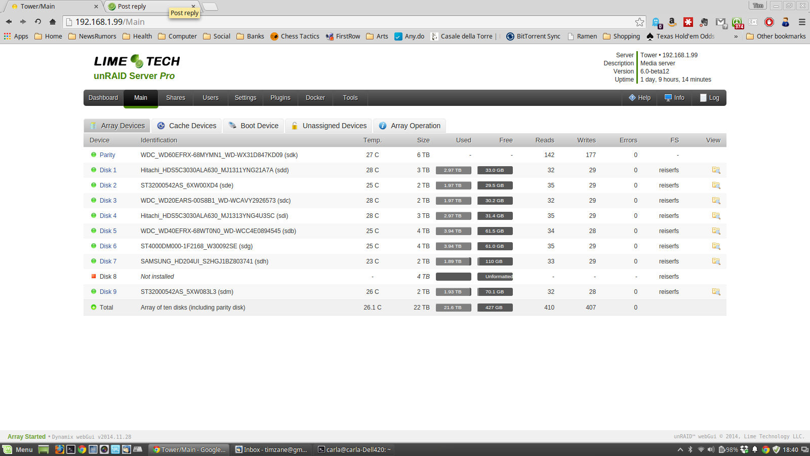

When I start the array with the disk removed , the array says disk is not installed.  This is not what I expected. I don't know how to see the data. Screenshot attached.
58aad77a7a232_Screenshot_from_2015-04-09_184003.jpg.47d13879145ba678b4d2d76d86fa67d1.jpg
This is what unraid shows when I try and select the disk.

Your first screenshot shows the array being started with one disk missing. In this situation, the drive is being simulated by parity and the other disks. Notice that the simulated disk is showing unformatted. This is unfortunate - I had hoped that by removing the physical disk the simulated disk would appear formatted.
The second screenshot shows that you stopped the array and re-assigned the physical disk to the slot. This is not what you want to do! The physical disk represents a possibility of recovering data, as does the simulated disk. Although it is possible that both disks represent the same state, this it not necessarily true. Bottom line - DO NOT START THE ARRAY WITH THE PHYSICAL DISK ASSIGNED TO THE SLOT. If you do, unRAID will immediately begin to overwrite the physical disk with the logical disk. And we know the result - the physical disk will still be unformatted.
What you should do is again remove the physical disk from the slot, start the array in maintenance mode, and run reiserfsck on the SIMULATED disk (/dev/md8). (This was option 3 in my earlier post). This will attempt to recover the data from the corrupted simulated disk. It will take potentially many hours to complete. You will still have the physical disk unaltered and may be able to try the same procedure on it if this fails. One of the other may succeed. Or they may both fail. We don't know. But if you rebuild the simulated disk on top of the physical disk - you know they will both have the identical result.
