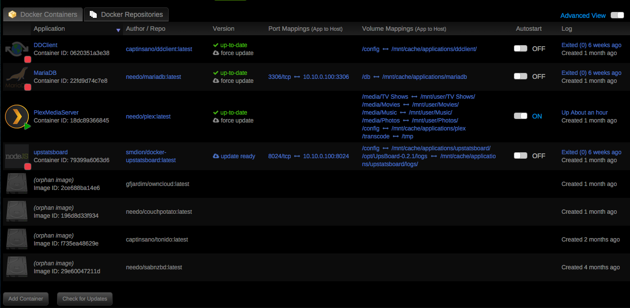

Well i'm having the same problem. Tried to remove the docker image and reboot my unraid server and reinstall docker, but nothing happens. In the plugin section i only have the Dynamix WebGui and the Unraid OS listed, so there should be no plugins, that mess the docker container section up.
Is it possible there is a problem with the Dynamix WebGui after the update to Unraid 6.0.0?
I somewhat got this working. Here are the steps I took.

The last error I got gave me the idea that maybe I should up the size of my docker image. I had it at 10G and I made it 15G. Then I disabled docker in the settings->docker section and applied. Then re-enabled it and applied. This got my docker tab back with some of my containers.

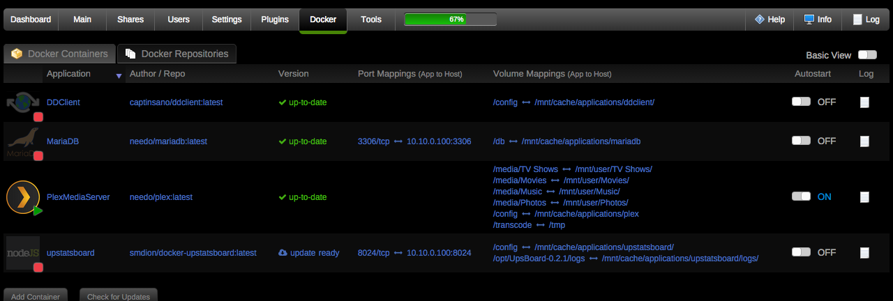

Though now I still have an issue. When I go to the docker tab I only have 4 containers (screenshot attached). Though when I run go to command line and run the docker images command I have a huge list of images with some of them being my missing ones and some I have no idea why they are there.
docker images -a

Does anyone have ideas on how I can get my missing ones (have a repository name) back in the web gui and how I can delete all the others? Plus I am not sure how I ended up with all those junk ones. I always use the web gui to create and delete docker images. Am I missing something when I delete them?
Doing that shows me 4 orphan images (screenshot) and it looks like they are the images I am missing. That still leaves a couple questions though.
[*]How do I get them so they are not orphans anymore without deleting them?
[*]That list of images I posted was huge and each one of those images was huge, can I delete those and how do I do it if I can?
Delete the orphaned containers first, it will do already quite a cleanup. Check afterwards what has left.
You need to re-install those containers to make them work (keep in mind these are only the applications, the data is still preserved).
Yeah I know it is only the applications but I always forget the settings I use for the containers, but that isn't that hard.
I don't quite understand what "it will do already quite a cleanup" means. I understand how to delete the 4 orphans but what about the huge list of images from the command line?
They may just be dependencies from the orphans and will be cleaned up when the orphans are deleted.
Also, your container settings should be saved in the templates that were created when you added the dockers. Just select one of the my-docker templates from the dropdown.
Well that sorta worked, but I still have a bunch of images with no containers. I ran the docker info command and it shows how many I have. Is it normal to have this many images?
