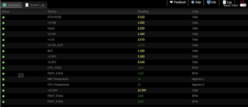

I'm having difficulty getting PWM fan speed control to work for the case intake/exhaust fans.  Currently running unRAID v6.0b14 on a Asrock E3C226D2I motherboard.  Three Noctua 120mm PWM NF-S12A fans are being used - 2 split from front_chassis header and 1 from rear_chassis header.  Both are 4-pins.  In the BIOS, the fan speed RPM is accurately reported and the fan speed can be manually set to different speed levels or to SmartFan, which varies the speed based on CPU temperature.  Both of these options work fine.  However, the fan speed should be based on array temperature.
In the BIOS and motherboard web GUI, the chassis fan speeds are reported correctly.  When running 'sensors' it shows the following:

Does your board only have 3 fan inputs? Mine has six but I only have 3 fans.  AA and CC are the same.  And EE is probably too but I have my 3rd fan connected to front fan2 so I tried FF.  This is the command I used
ipmitool raw 0x3a 0x01 0x64 0x00 0x64 0x00 0x00 0x64 0x00 0x00
And magic. All fans went full speed. I tried them individually too. Changed 64's back to 00 and fans went back to smart fan mode. So I would assume for the my c2750 this would apply:

This is an old topic and it seems that you guy's have fixed your issue around the fan control. But I have a similar issue with the ASRock - E3C224D4I-14S and wanted to understand how you did it.
I have attached the screenshot of IPMI Tools that Dmacias kindly provided. Seems that this is how my 4 pin PWM fans are being attached to the mobo:
AA: CPU_FAN1
BB: Rear Fan
CC: Lower Front Fan
DD: Upper Front Fan
EE: Set to 0
FF: Set to 0
GG: Set to 0
HH: Set to 0
I was playing around with the ipmi command and this was setting all back to Smart Control Mode:
ipmitool raw 0x3a 0x01 0x00 0x00 0x00 0x00 0x00 0x00 0x00 0x00
I saw the script from Dmacias and Gfjardim a few post's back but don't know what to do with it.
Second question is: can I remove the "Dynamix Auto Fan Control" as it is not working with this board anyhow?
Thank you very much.
AA: CPU_FAN1
BB: Rear Fan
CC: Lower Front Fan
DD: Upper Front Fan
EE: Set to 0
FF: Set to 0
GG: Set to 0
HH: Set to 0
The IPMI plugin already installs ipmitools. I haven't made much progress other than starting an IPMIFans.page for input. The DO YOUR STUFF HERE part of the script is what needs to be modified. The only thing I've added to the plugin is ipmi event monitoring and notifications. I hadn't spent much time on fan control because of limited time and since my heat issues were solved by putting a plastic barrier between the motherboard and fans thus forcing all intake air through the drive cage. I've been meaning to get back to the fan control. I've started working on it some since adding event notifications.
You can remove the Dynamix Auto Fan Control.
