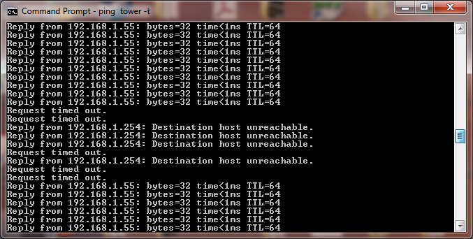

I have a 4 disk setup running on Unraid 5.0.6 Pro.  Parity with 3 data disks.  I recently deleted some files from my data disk1 and am trying to copy new large files to this drive.  The file starts to copy but connectivity drops in the middle of the transfer.  I've swapped out the switch, cable,and have even tried from a different computer/os.  I attached a screenshot showing the ping of what happens while the file is transferring mid fail.  I was pinging the host name not the direct IP address.  I am configured for DHCP not static.  I find it very strange that it changes from pinging 192.168.1.55 to 192.168.1.254 in the middle of the transfer.  It almost seems like Unraid is having the issue, not my network.

OK so after some thought I decided to ping the ip address as well as the host name.  The ip address and host name both stopped responding at the same time but the ip address ping did not change over to the different address.  From there I found out that the computer I was copying from was the 192.168.1.254 ip address and windows pings it's own ip address\gateway after getting no response from the network for a period of time.  So that part of my post is solved.
So now i know that the unraid box is falling off the network in the middle of the transfer. I do not have this problem while playing files back or copying files to other drives.  It only seems to happen on the drive that i freed up space on and then tried to copy files back onto that drive.
