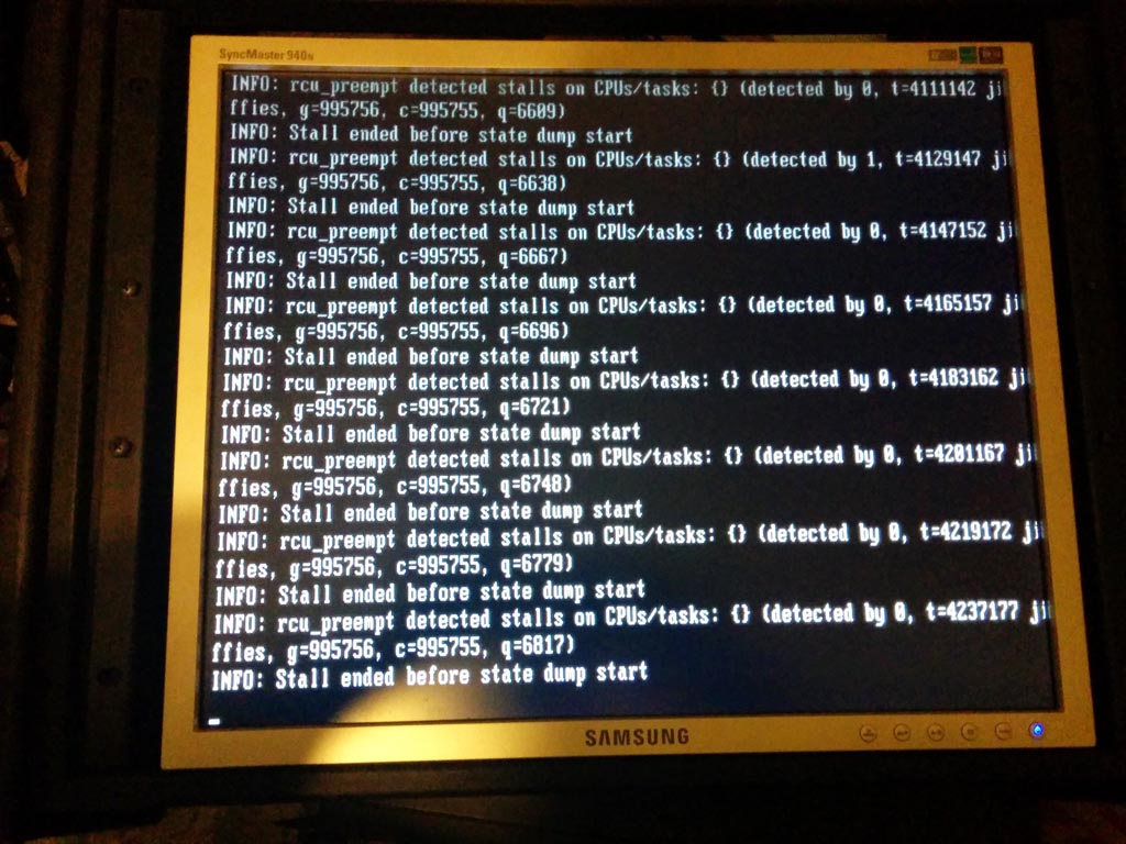

2. More worryingly, the last message on the monitor is "*** Error in '/usr/bin/php': Corrupted double-linked list: 0x00002b3b9d7ade58 ***
Apologies, but I've had a busy week and haven't been able to reinstall my unRaid v6b15 box and start a new topic logging everything.
However, my unRaid system had crashed twice in the last week, so it's been mainly running parity checks.  One of the crashes I took a photo of (couldn't get to any system logs - nothing on the network, but hopefully it might provide some insight).
I woke up this morning to find the above quoted error message on the screen again.  UnRaid is still running on my network, I can putty into it but the web interface doesn't seem to be up.
A brief outline of my system - I should have some time this weekend to strip it down and log everything properly: 2GB RAM, 12 x WD Green drives (mixture of 1 & 2 Tb) Gigabyte G33-DS3R motherboard with Supermicro 8 port SATA PCI card, Corsair PSU (can't recall which one without opening up - decent one though).
I would suggest that you start your own thread under 'General Support' on the Version 6 Support area of the board.  Doing that will assist those trying to help you by keeping all of  the  posts together.
Definitely open up a separate thread for this.  And when you do also attach a couple of syslogs.  One from when you can get to the GUI, and another from when you can't (do it through putty) = http://lime-technology.com/wiki/index.php/Troubleshooting#Capturing_your_syslog
