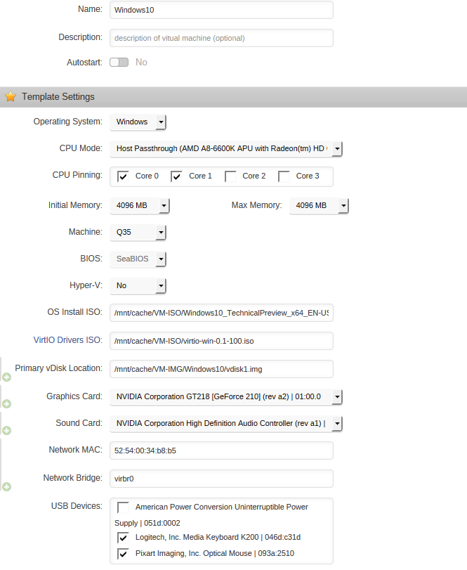

Installed the latest version and everything seems to work OK - did uninstall the VM manager before the required reboot.
The only one thing I cannot figure out is how to pass a graphics card for a Win10 VM.
I used both SeaBIOS and OVMF w/ and w/o  "ACS overrides" but I cannot get anything out of my GeForce 210 PCIE card. The card has VGA, HDI and DVI outputs - is rather old and maybe here lies the issue.
The mouse and keyboard attached to the system do pass trough it's just the graphics card that doesn't seem to cooperate.
Before I go about and get a new card I need to make sure that I did try all the options.
Thanks.
Edit:
Did try again with the configuration shown in the picture attached and the system did reboot :(
Now the flash drive seems to be read only, will check the drive after ~ 8 hours when the parity check finishes.

2)  Load your ROM BIOS for the GPU manually.
To do the latter, you will first need to find your BIOS from this site:  http://www.techpowerup.com/vgabios/
Download the bin for your BIOS and save it to somewhere on your cache or in the array.
Edit the XML for your VM through the webGui.  Locate the section for your GPU pass through which will look like this:
      <driver name='vfio'/>
      <source>
        <address domain='0x0000' bus='0x01' slot='0x00' function='0x0'/>
      </source>
    </hostdev>
Add the following after the </source> but before the </hostdev>:
<rom bar='on' file='/mnt/path/to/rom.bin'/>
Replace the file path to the path of your bin file.
I've had much easier success with NVIDIA devices that have UEFI BIOS than AMD.  I actually don't have any AMD cards that have UEFI capability.  Even a modern R9-290 I got from ASUS about a year ago doesn't have UEFI support.  With NVIDIA, most devices as of the 650 series and up seem to have it, and I've had particularly good luck with EVGA.
Give these things a go and let me know how it goes.  There are a few other things we can try as well.  I'd be inclined to have you try that GPU without the OVMF setting (bet it would work), but let's keep trying OVMF first, as it is definitely going to be the preferred method.
