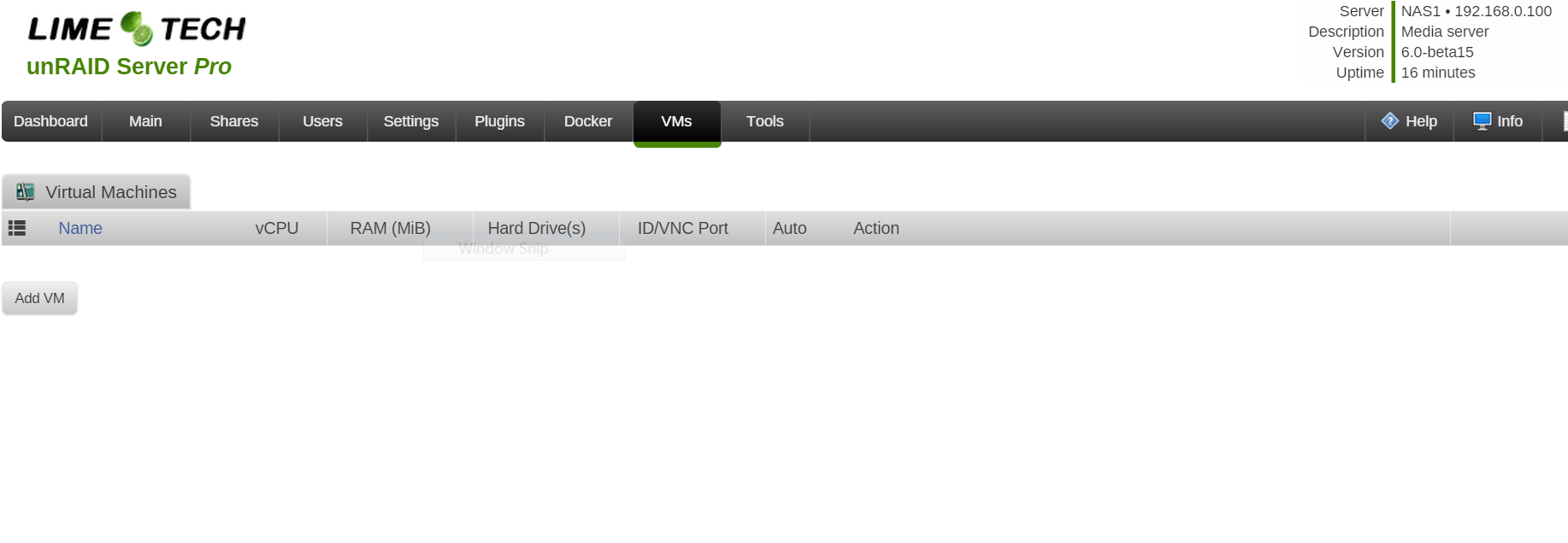

Am I supposed to have to do anything for the new VM manager to see my existing KVM VM's?  I just get an empty VM's tab.
I read through this tread and didn't see where I should have to recreate them here.  Did something go wrong?  I removed the libvirt/kvm plugin's then used the webgui to update from b14 to b15
Go to the settings tab.  Click VM Manager.  Turn "enable" to yes if not already set, then click apply.  If already set, try setting to "no", then apply, then yes, then apply.  See if this resolves your issue (this is essentially restarting libvirt if not already started).
Also, did you clear your browser cache?
No Joy.
Edit 1
I do not see my .xml's in /etc/libvirt
root@NAS1:/etc/libvirt# ls -ltr
total 42

Did I just miss some step?  Should they be there?  I have backup's should I put them there under qemu?
Edit 2:
I copied my .xml's for the domain's and the lan (had a vlan.xml moved it into networks)  restarted and my vm's show up now. Started my windows 7 and it seems to be up/running ok.
Hmm, did you have the separate plugins for libvirt and vm manager previously?  Wondering if the libvirt plugin removal script removed the domain.cfg file. Its not a huge issue. You can copy the xml back to /etc/libvirt/qemu folder.
I hadn't looked but assumed the loopback image was still being used since my vm's started.  Depending on what version of the previous plugin/plugins he was using, the image may have been in /boot/config/plugins/virtman instead of dynamix.kvm.manager. I had some code in the newer plg that would check for the old location and file, then rename to domain.img and move to the new location.
Do I need to do anything else after copying my .xml files back to /etc/libvirt/qemu?  Will that solution survive a reboot?  I copied three OS.xml files and one network/vlan.xml file.
